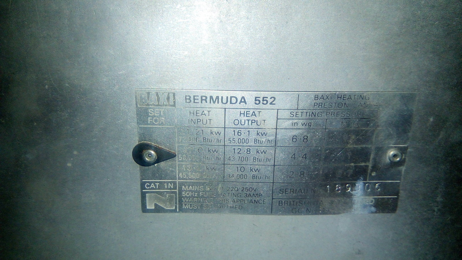

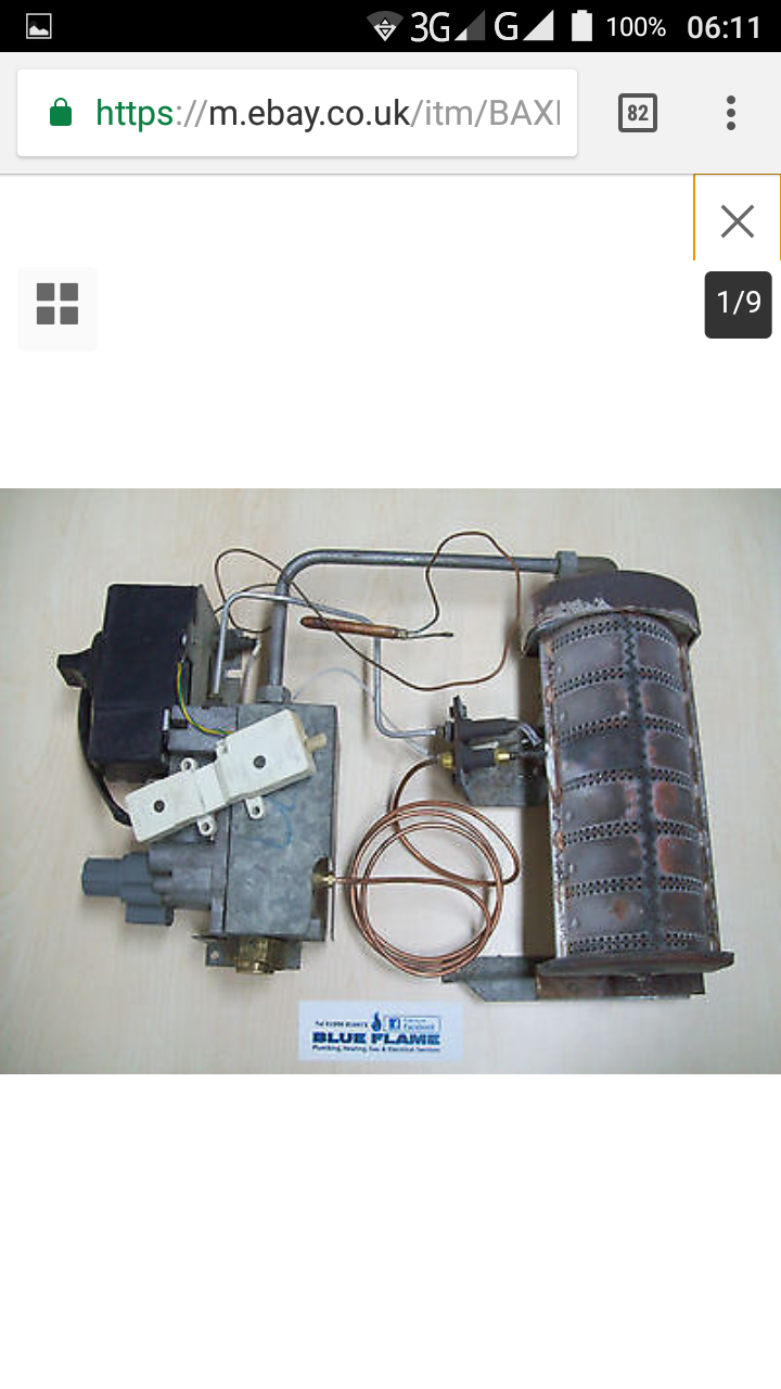

Hi I've just bought a house with a Baxi 552 boiler fitted it has been partially dismantled and the burner is missing parts I wonder if anyone tell me will the burner from a 401 fit ? The back boiler itself seems to be ok no leaks. Can anybody tell me any help would be well appreciated

ive been offered a whole 552 boiler and fire front , think i'll buy it and have mine replaced, is it possible to flip the boiler inside as my pipes come out on the right and the one ive been offered is on the left.
You won't be able to do that I'm afraid - energy efficiency regulations say that any replacement boiler must be A-rated, so fitting a complete new 552 isn't permitted and can't be signed off. Why not have your Gas Safe Registered Engineer strip out the bits you need from the replacement boiler and fit them into the new one?
401 will not fit it is to narrow,buy the 552 and get a gasman to swop over the burner tray and test it.
