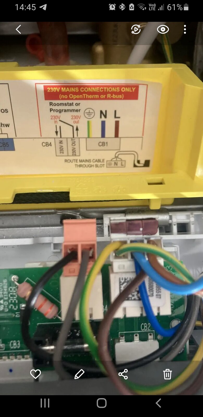

Hopefully someone can help me, I’m wiring a new honeywell T4r receiver into a new Baxi 830 combi
Done some research but can’t the exact information.
Currently have baseplate in and I’m wiring the power from the boiler aswell using (0.75mm) 5 core cable.
The Baxi has 2 terminals I think for SL in and out.

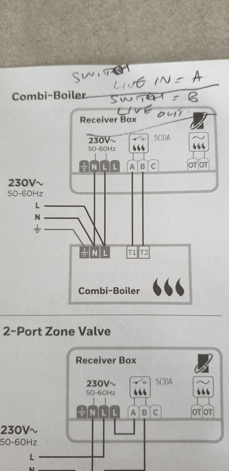

Does the left terminal (black cable) on the boiler "T1" (live in) go into "A" on the receiver?
If so, this should mean that "T2" (grey wire) leads to "B" on the receiver?
Thanks in advance ☺
I would say the other way, but doesn’t really matter as it’s just a switch
