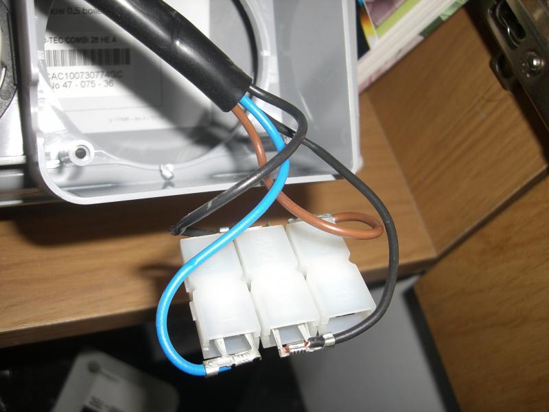

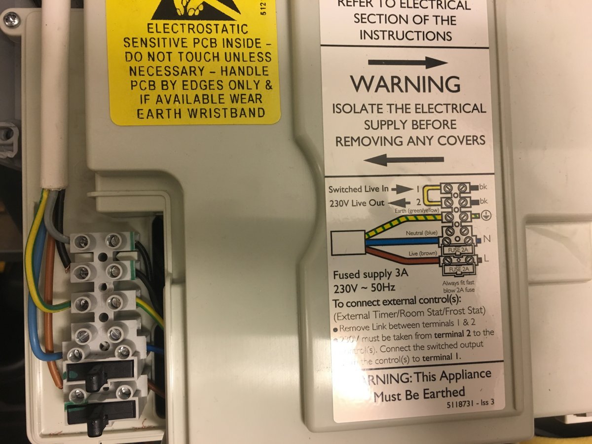

thanks for your reply. If I remove the receiver should I connect the nest heat link into these connections or should it be connected into the main terminal block these photos are not my actual boiler the main terminal block on mine still has the link fitted in 1 and 2 and the receiver is still fitted to the cables in picture 2 boiler-wiring.jpg 20773649.jpg
First of all I have a suspicion that with your model of boiler that to access the wiring terminals you might have to open up a room sealed section of the boiler to access them. If you do, then this is not a DIY job and should only be done by an RGI (Gas Safe) engineer who can carry out the necessary safety checks afterwards to make sure that it is sealed up properly again. But I might be wrong on this as I can't remember the details of every model of boiler!
Secondly, as you mention, the photo's you have posted which are not from your boiler, won't represent what you have because they are from a boiler that doesn't have an internal receiver fitted, and has external remote controls installed already to boiler terminals 1 & 2.
Having said that, if the wiring terminals are accessible without opening up a sealed part of the boiler, then the Heat link connects to the terminals below.
The mains supply for the Nest Heat link goes into the boiler L N & Earth terminals along with the existing wires already there.
Remove the link between boiler terminals 1 & 2
Nest (2) 'heating common' goes to boiler terminal 2
Nest (3) 'heating call for heat' goes to boiler terminal 1

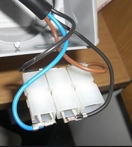

Regarding the other photo, that is a 3 way block that is fitted when there isn't a remote receiver attached. When there is a receiver, the wires in that connector would go to the receiver. So to remove the receiver it is necessary to replicate what is shown below. The 2 black wires are connected together, and the brown and blue wires insulated / isolated separately.
