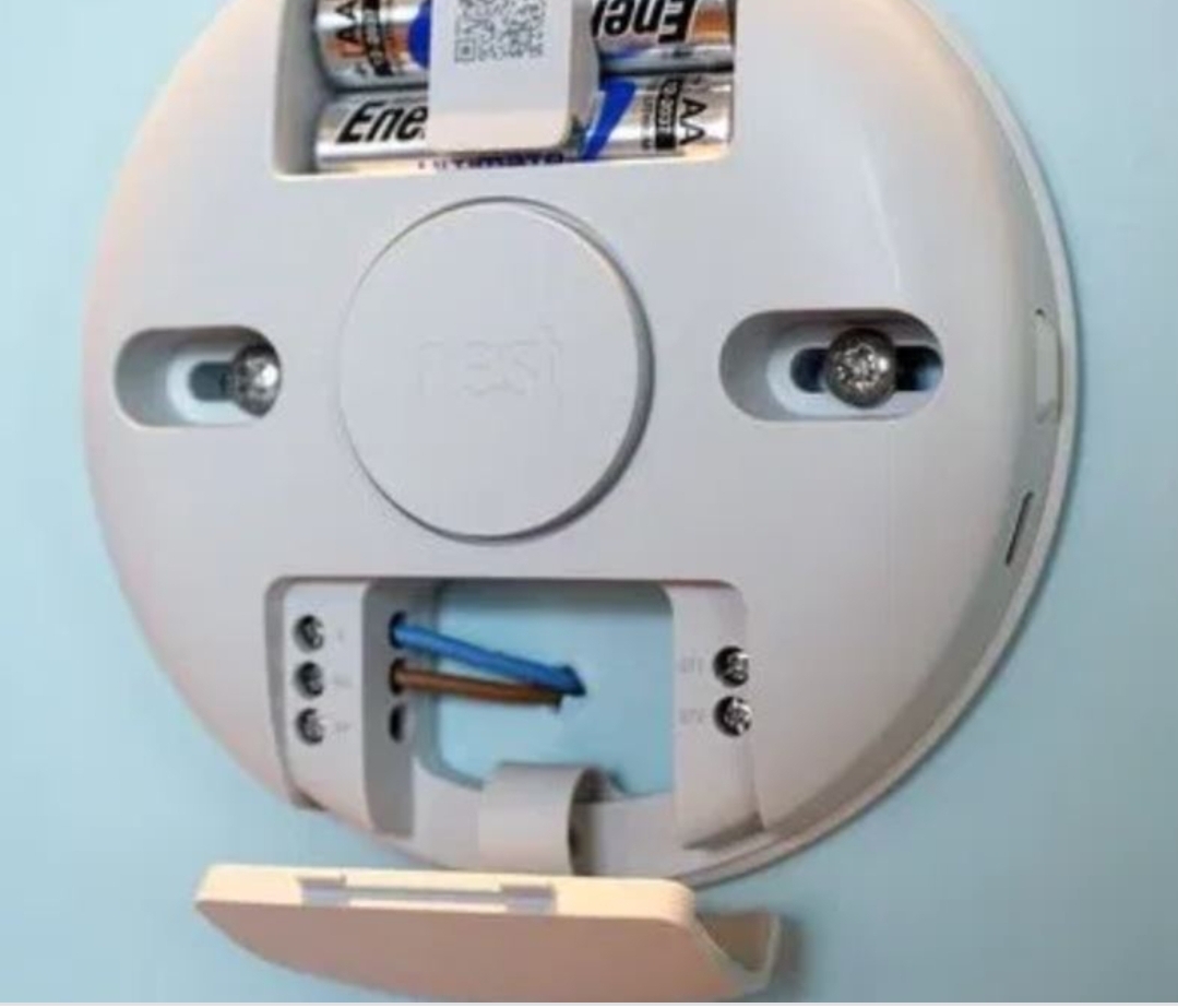

Hi , ive wired up my nest e to my baxi duo tec combi , looked very straight forward, just wired the link in but the heating is continuously on , and the thermostat has no control at all ??
post a pic of how you have wired it (from both ends) it is simply a switch nothing hard about wiring it up
Same as that mate, then just into the stat connections on the boiler , ive a esi wireless stat at the min which works fine , ive even re fit the esi stat and still works fine , soon as I wire the nest in it continuously calls for heat
Yep that is how it is wired , how are the wires wired at the other end ? I am guessing you have completely removed the wiring for the esi stat ?
