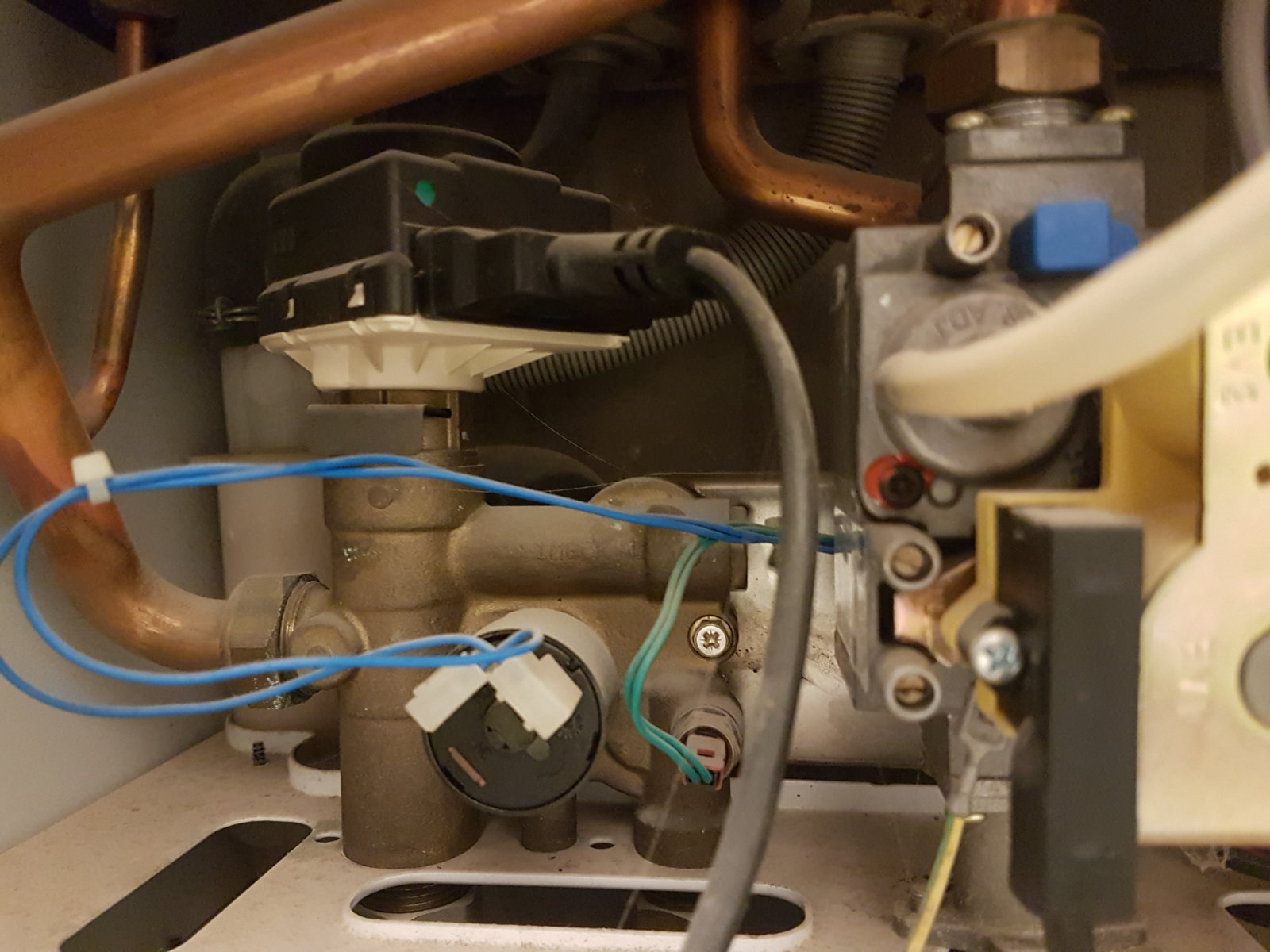

What usually happens is the cartridge under the motorised valve leaks,water goes into the head and damages it,as well as the plug in electrical connector..If any signs of leak under head,water been running down brass,that is what has happened

This is a pic of the inside of boiler
call Baxi with the serial number of your boiler and they will give you the correct part number
