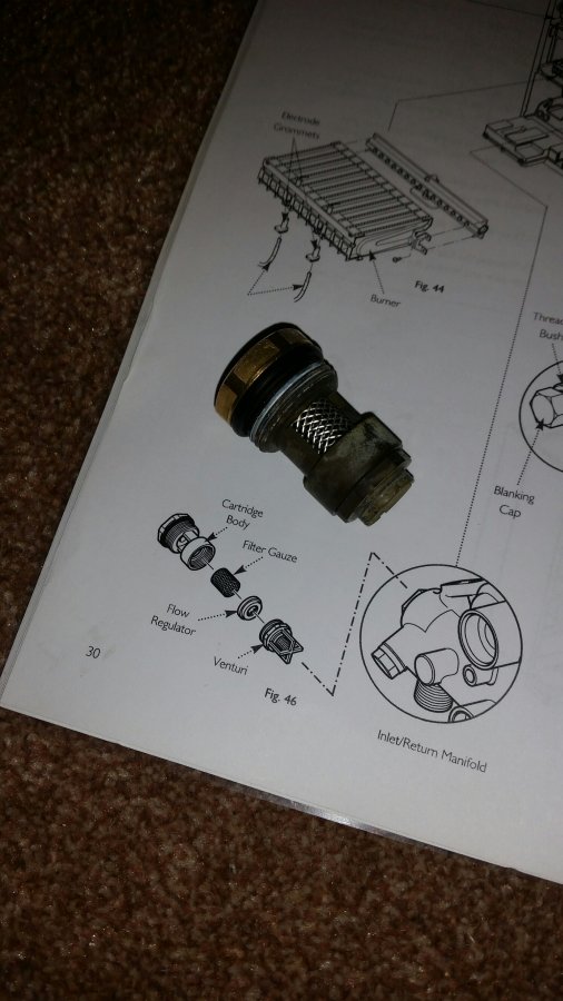

It has an Baxi Instant 80HE, which only intermittently detects HW flow... It works when I turn on the bath tap (lots of water), but not the sinks..
I have looked at the mechanism which detects flow, and its obvious what the issue is.. When I turn on the tap, the "pin" that presses the microswitch comes out long and hard.. But when I turn on the sink taps, it only comes out 1/2 way and I can easily push it back.
At the weekend I had a look at the diaphragm and associated mechanism and it was sound.. I cleaned of a bit of scale and it made little difference.
So then I moved onto the "Venturi" which was something that Baxi told me to look at. They said that sometimes the splines come off of the cage. So I removed the cartridge, and to my surprise, the Venturi was missing. I checked inside the opening with a mirror/torch and its not there. The Venturi is awol.
So I would hope this could be the cause.. But a call to Baxi today resulted in them telling me that it WAS there as teh boiler wouldn't work at all without it. They refused to accept that in my case the venturi was missing.. And the boiler works some times and simply refused to speak to me.
Does anyone with Baxi knowledge know why my venturi is missing? And why the boiler still works??.

Here is my cartridge... I am not missing something? Would you agree the venturi is missing?

No I am not.. I am replacing the whole thing.. Just replacing the Venturi was temping (And not unreasonable, as it has its own part number and is easily installed onto the end of the cartridge), but I figured the whole cartridge was better and it only cost £3 more so it was a no brainer.

Venturi will sort it. Baxi tech are talking rubbish. He has probably never worked in the field and seen these boilers work without the venturi intact. The venturi is probably in little bits in the plate heat exchanger.

If, and we don't know, any professional intentionally removed the venturi, then it was probably done to increase the water flow through the boiler as they do cause a big restriction.

I would just leave it. They break up in to tiny pieces so it's unlikely to cause an issue.
Just to give an update and closure.. Replaced the cartridge today. Before doing it I spent a while to check the chamber and it was completely empty.
And now the problem is entirely solved.. The taps trigger the boiler as soon as they are switched on.. And I checked the push rod into the microswitch and where as before it was "limp".. Its now shoots out like a dog on heat.
