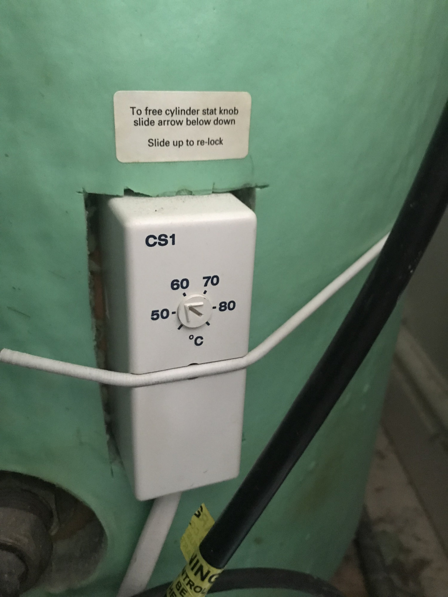

Anyway thanks for the help but what you are telling me is beyond my skills, I’ve no idea about zones or anything, there’s just the boiler, pump, actuator and a thermostat on the tank. Can’t see anything else.

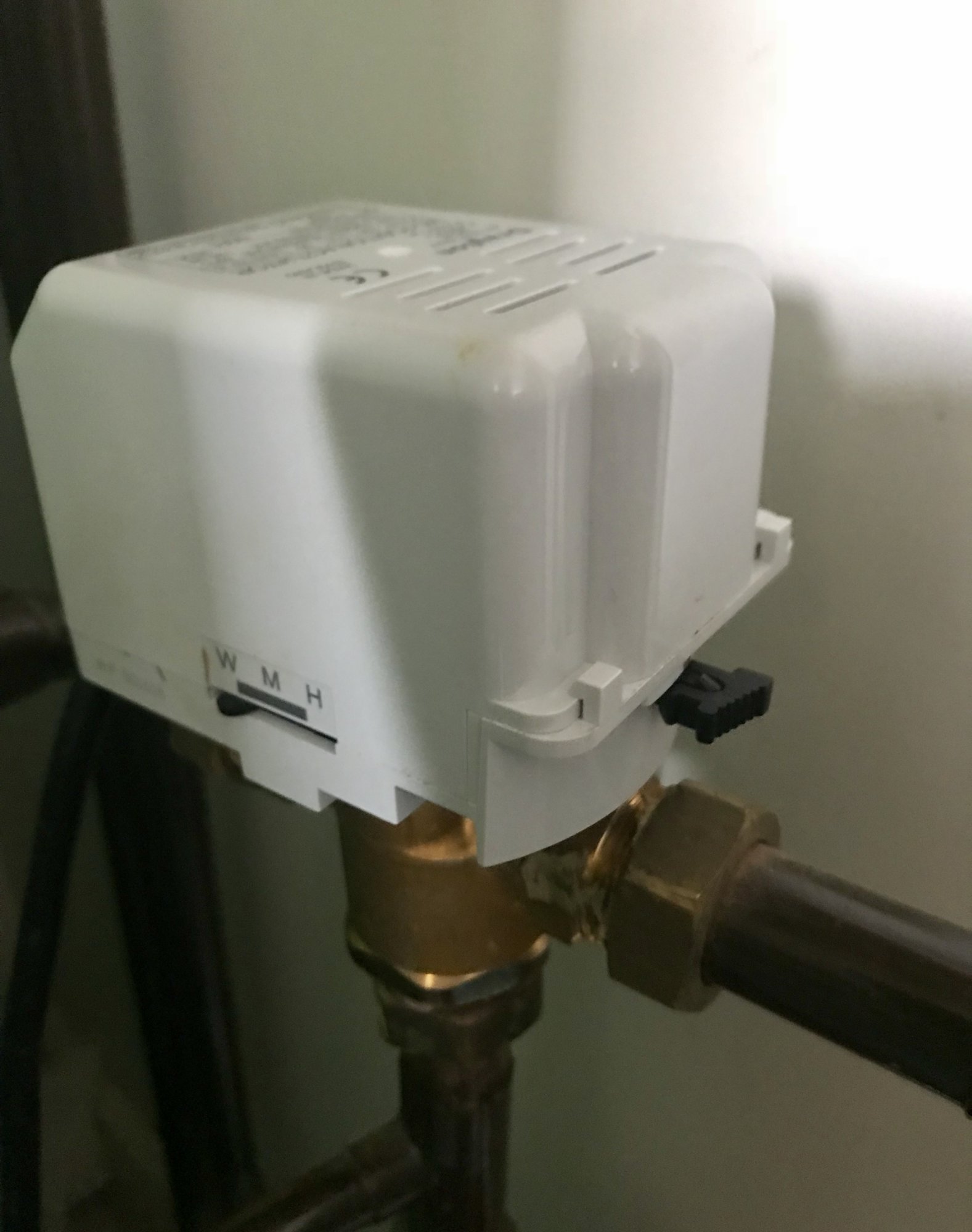

post some pics of what you have, as in what you are calling an actuator, (your boiler doesnt have one) I suspect you mean a 3 port valve, basically when your boiler senses that the demand for heat has stopped then the burner will switch off but the boiler will keep the pump running to cool the boiler, if the pump cant move this heat it will keep running , a photo of your set up will help us give you the advice that you need

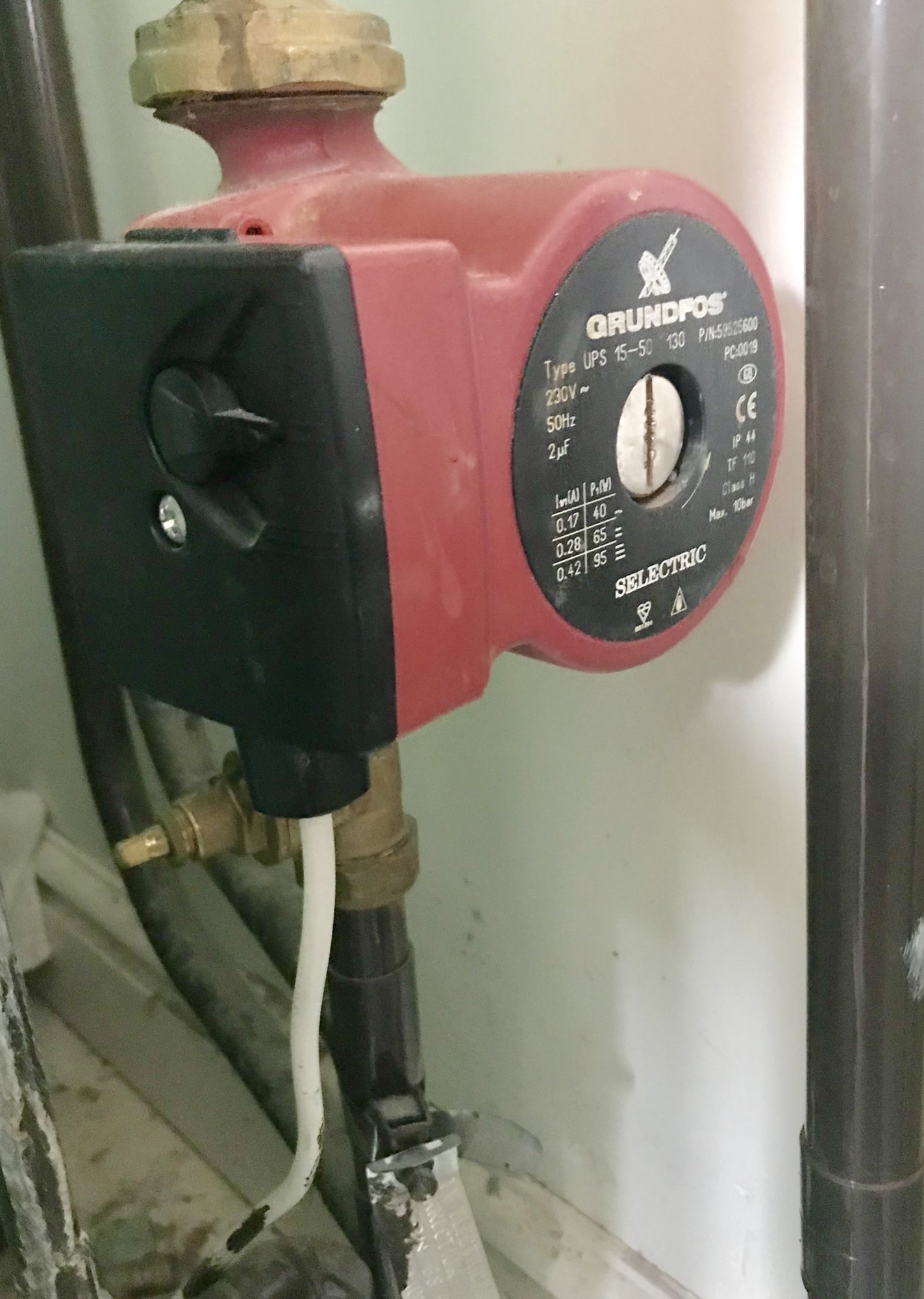

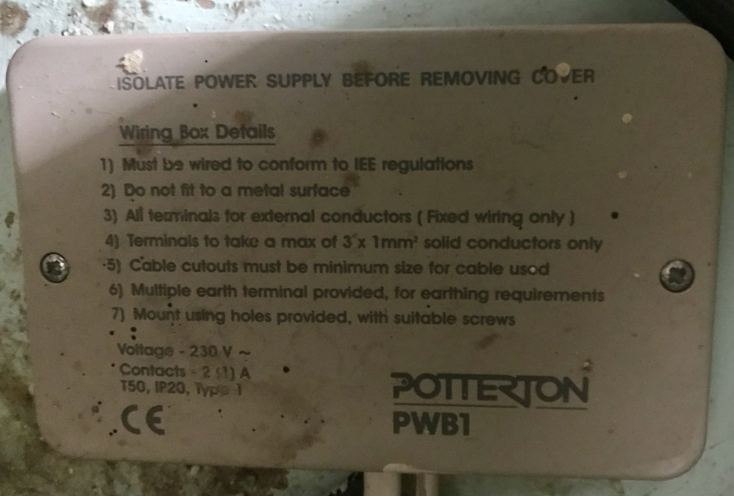

Ok so pics .. boiler in kitchen feeds to airing cupboard. This potterton panel is on airing cupboard floor, this has cables to pump etc. Pump is red/black. Actuator sits above pump.
The pump is definitely the thing being kept on... can feel it vibrating the actuator. Adjusting the level on left of the pump seems to increase or decrease the power.
Hopefully your pump is wired directly to your boiler. This could possibly be the main cause of your problems if not. I’ve saw this before. Mainly on big system installs where hotwater is needed 24 hours a day.
its not an actuator, it is a mid position or three way valve the plastic bit on the top of it is the actuator

As it has worked OK previously, it would seem to be wired OK, but the wiring is easy to check too. The pump should be wired directly to the boiler PCB terminals provided for it. So that the boiler has exclusive control of the pump without any external influences.

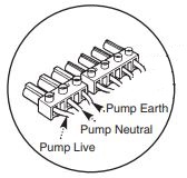

Wiring is as per the diagram. However there is no pump neutral or pump earth, just a pump live.

The pump will pick up the earth and neutral from somewhere else then. That's not unusual, as long as the 'live' is connected properly, because that's what controls the operation of the pump and switches it on / off. It is possible that it has been wired up incorrectly, in that there may be another 'live' connected to the pump from somewhere else, but if it used to work OK, and the pump wiring hasn't been changed that wouldn't be a concern.
Also, if the 'Boiler On' light is going out, you can forget about the problem being caused by any external controls such as the cylinder thermostat or motorised valve. If they were causing it, the 'Boiler On' light would still be lit. Once the 'Boiler On' light is extinguished, the timed overrun of the pump is controlled by the PCB.

Just as an afterthought, and in light of your comments about it happening frequently and so quickly, I was wondering if there maybe a problem with the pump, in that it is drawing too much current through the PCB and thus damaging it. I'm not sure of the design parameters to know how to check it....but was just thinking...
