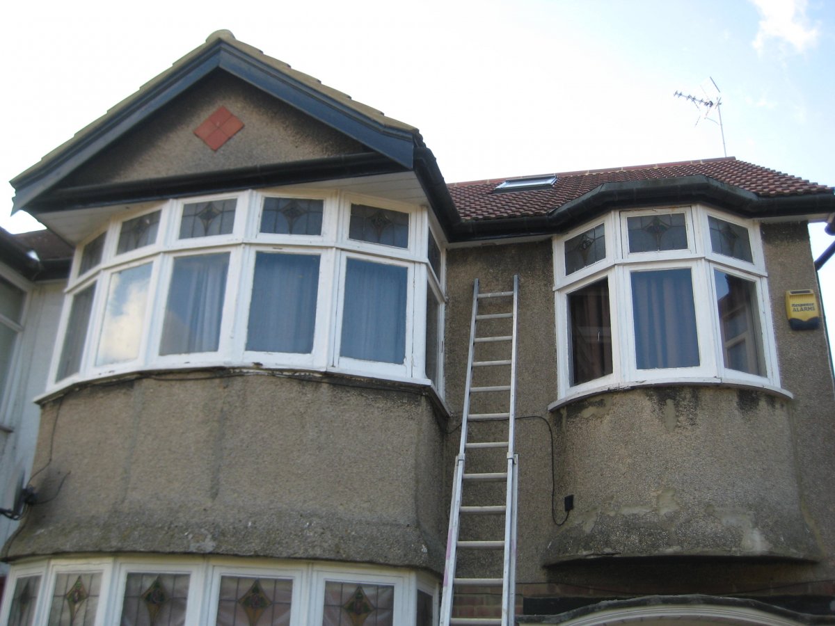

I have previous experience of fitting straight uPVC windows, and am now to replace some old timber Bay windows, they are quite large: 7 segment, total width 3mt, projection 1.2mt.
I lack surveying experience when it comes to Bays though.
I am aware the old windows provide structural support, I am being offered windows with a 38mm 1.8mm aluminium pole (6x poles in total), the on-line windows supplier does not sell the thicker 2.7mm pole, I have asked why no thicker poles available, but they will not commit to any questions I have, or look at an image of my property - they state they 'are not fitters' !
Here is an image of the window to be replaced, it has a tiled (large format tiles) gabled roof, with brick and rendered gable wall on the first floor above, and then a rendered brick wall above ground floor - so I would have thought quite a bit of weight.
I have a 'load bearing' chart for the tube, which shows an approx 1 tonne capacity at 1.4mt height for each 1.8mm thick pole for the top floor, and 0.75 tonne at 1.8mt height for the ground floor, so as long as I can spread the load at the head of the window - then 6 tonne capacity for each set of windows will be provided.
Do I take it from the manufacturer (who supplied the load capacity chart - attached) that the 1.8mm and 2.8mm poles are a 'fits all' for 1930's semi's.
On a side issue, The window supplier has not made provision for Pole Jacks or spreader plates, so not sure how they expect you to get the poles in place - am I missing something here, do you simply shim out, wedging top and bottom then lower acros ... jacks just seem an easier way of working.

You may just want to add what make of windows you are planning to use incase anyone here is familiar with them, Also the angles of you bays.
Just had a quick look in my Liniar specification guide and I have a choice of 12 different bay poles and 4 pole jacks. All with Axial load charts.
My guys have both a 135 degree or 150 degree fixed angle poles or various round and bow poles.
I think it all on the hardware download (6th down on left hand side) of this page http://www.liniar.co.uk/downloads/
But like I say it depends on what make of windows you are going with

Angles between facets:
1 and 2 = 120 deg.
2 and 3 = 165 deg.
3 and 4 = 165 deg.
5 and 6 = 165 deg.
6 and 7 = 120 deg.
I'm interested to know why the angle is significant.

I only asked about the angles as the fixed angle posts (135&150 degree) are much more heavy duty.
To be honest the way most company's I have worked for just specify the largest post that will fit the angles. Until I started up on my own (after 15 years of fitting for others) and did my own research I had never even heard of spreader plates and bay pole jacks :confused:
