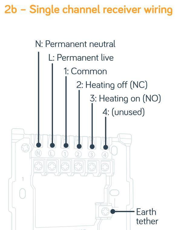

I just bought a Hive and want to double check the correct wiring.

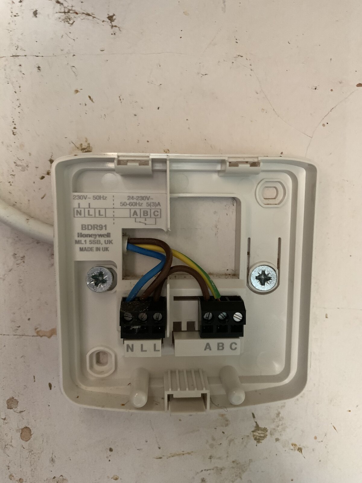

I have currently installed the Honeywell BDR91 (to Hive - Combi Boiler) like this:

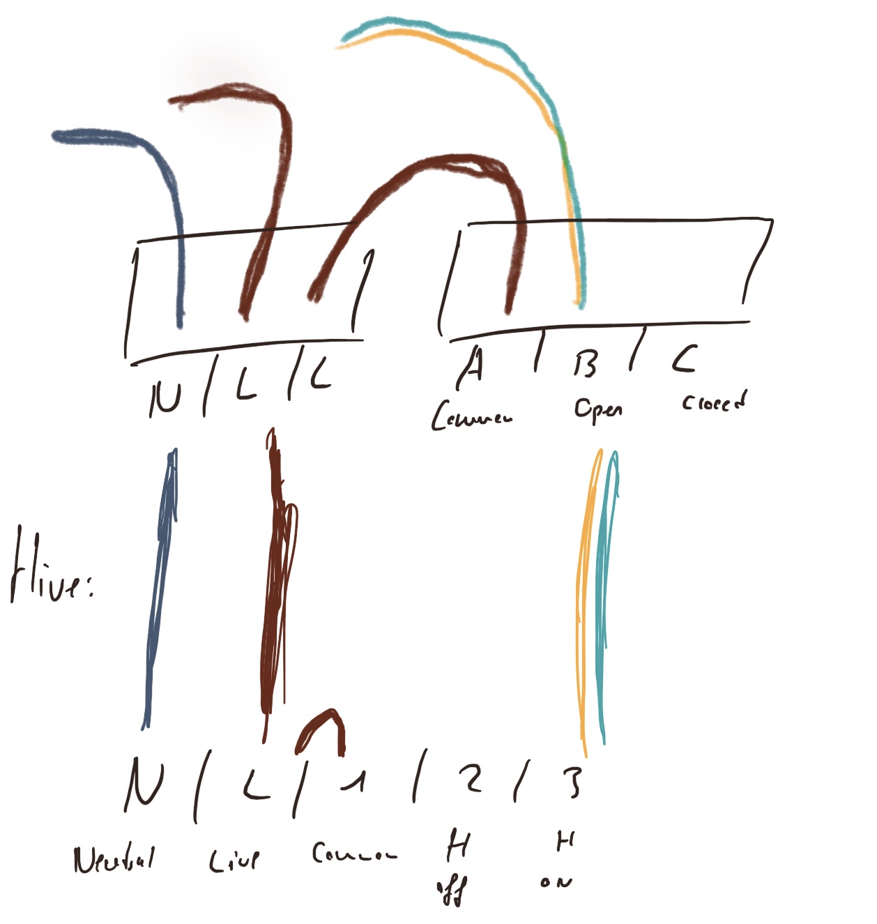

Would probably wire it as the following, but hopefully someone can confirm or correct the setup:
Thank you!
your wiring is correct but put a sheath or tape on the green/yellow wire to show it is being used as a switched live
