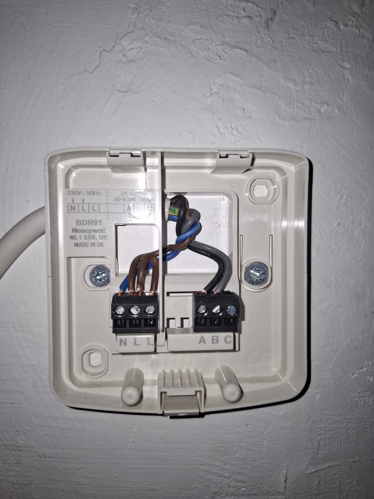

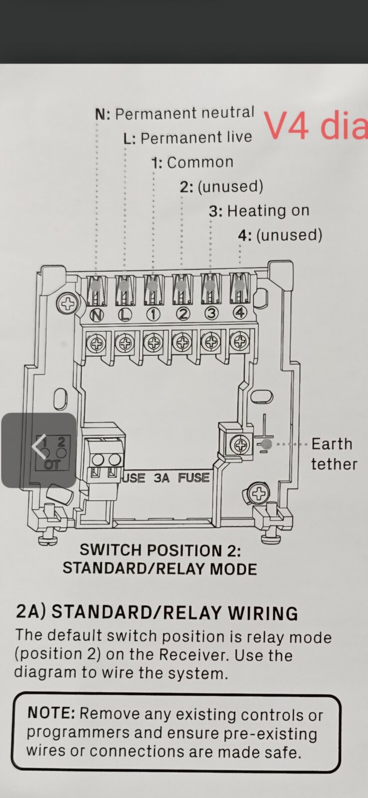

Hi,
I know similar has been posted before, but I can't find the same wiring configuration. I wonder if the current wiring configuration I have can easily be replaced with a Hive v4 reciever without changing the wiring in the boiler - Vaillant Ecotec Pure 835 combi? If so which wires would go where? I'm not sure what the linked live is.
I presume:
Neutral wire to neutral
Both live wires to live
Back wire to common
Grey wire to position 3
Thank you

That should work.
Thank you. What do i do with the linked wire going from live to live?
