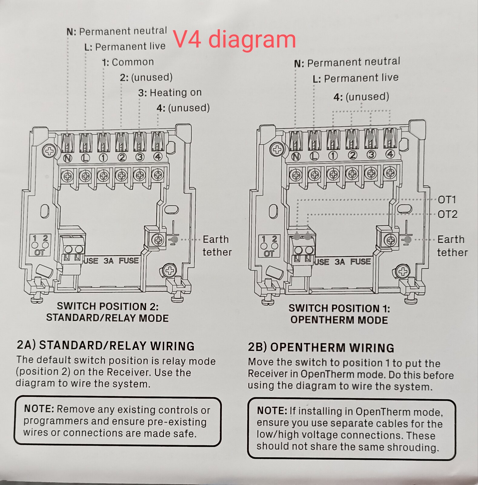

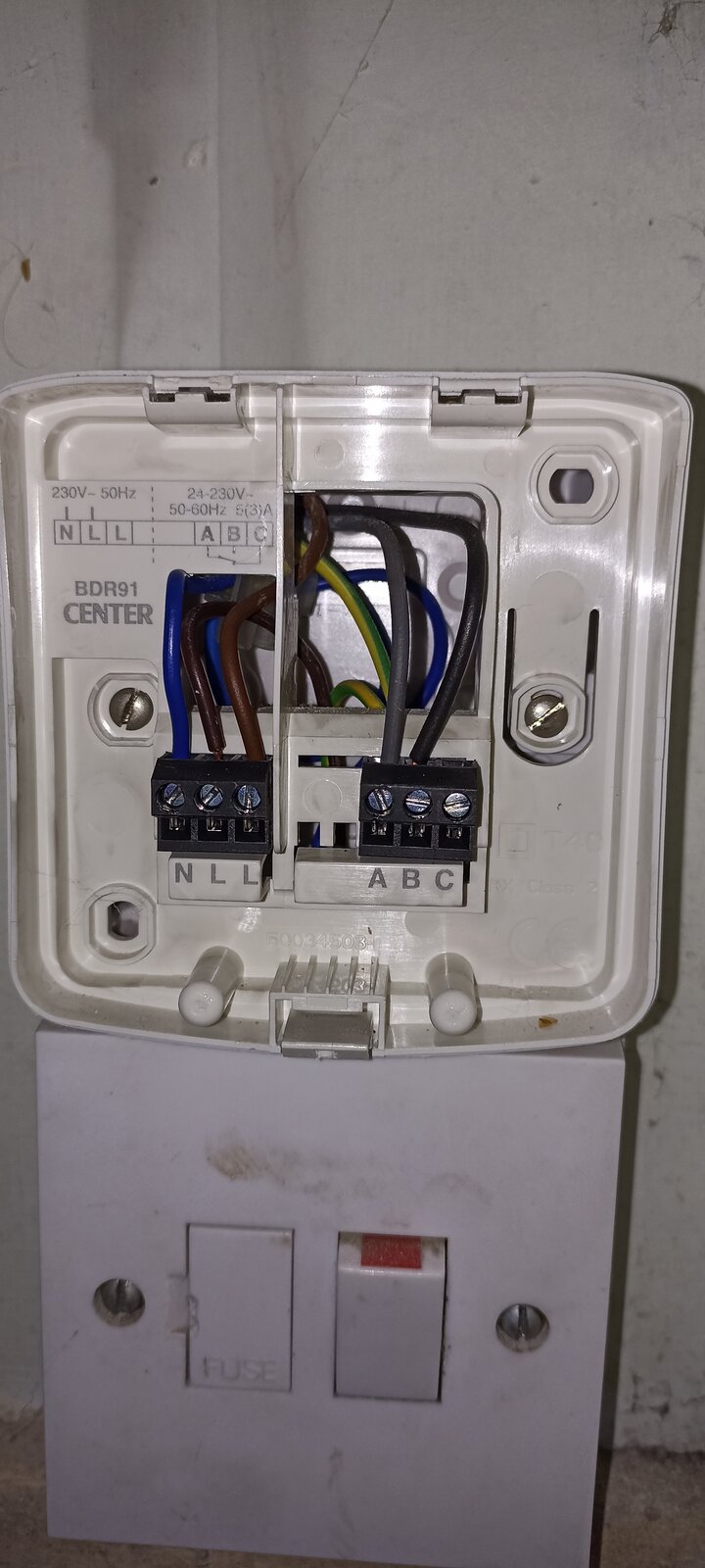

Bought a Hive combi V4 but need advice on wiring it up
Currently I have a Center wireless stat fitted
N - neutral from fused spur
L - live from fused spur
L - live to boiler
A and B heating control wires from boiler
Images attached
**Am I being a div and it's as simple as
Neutral wire to neutral
Both live wires to live
Grey wire to common
Black wire to position 3

The hardest part was mounting it onto a 47mm back box (with the help of some spacers)
The initial installation had the center WiFi controller directly above the fused on/off mains switch for the boiler. The back box was needed for clearance to access the two retaining screws on the bottom of the hive receiver.

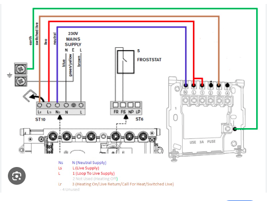

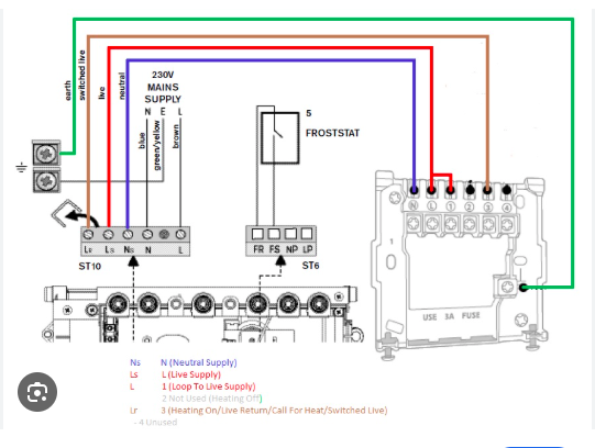

I have a HIve V4 and want to install the Receiver on a Worcester Bosch Greenstar R30 HE (2005)
Is this the correct wiring diagram for it ?
Thank you :unsure:
