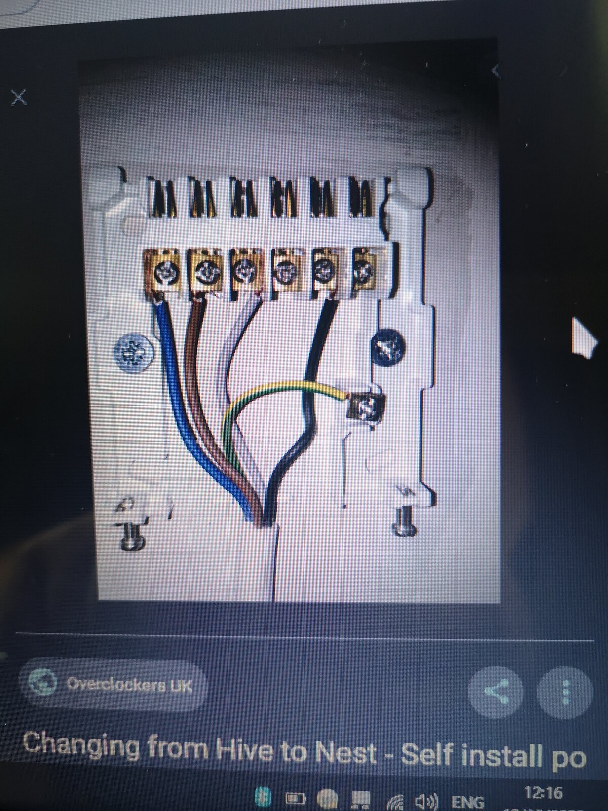

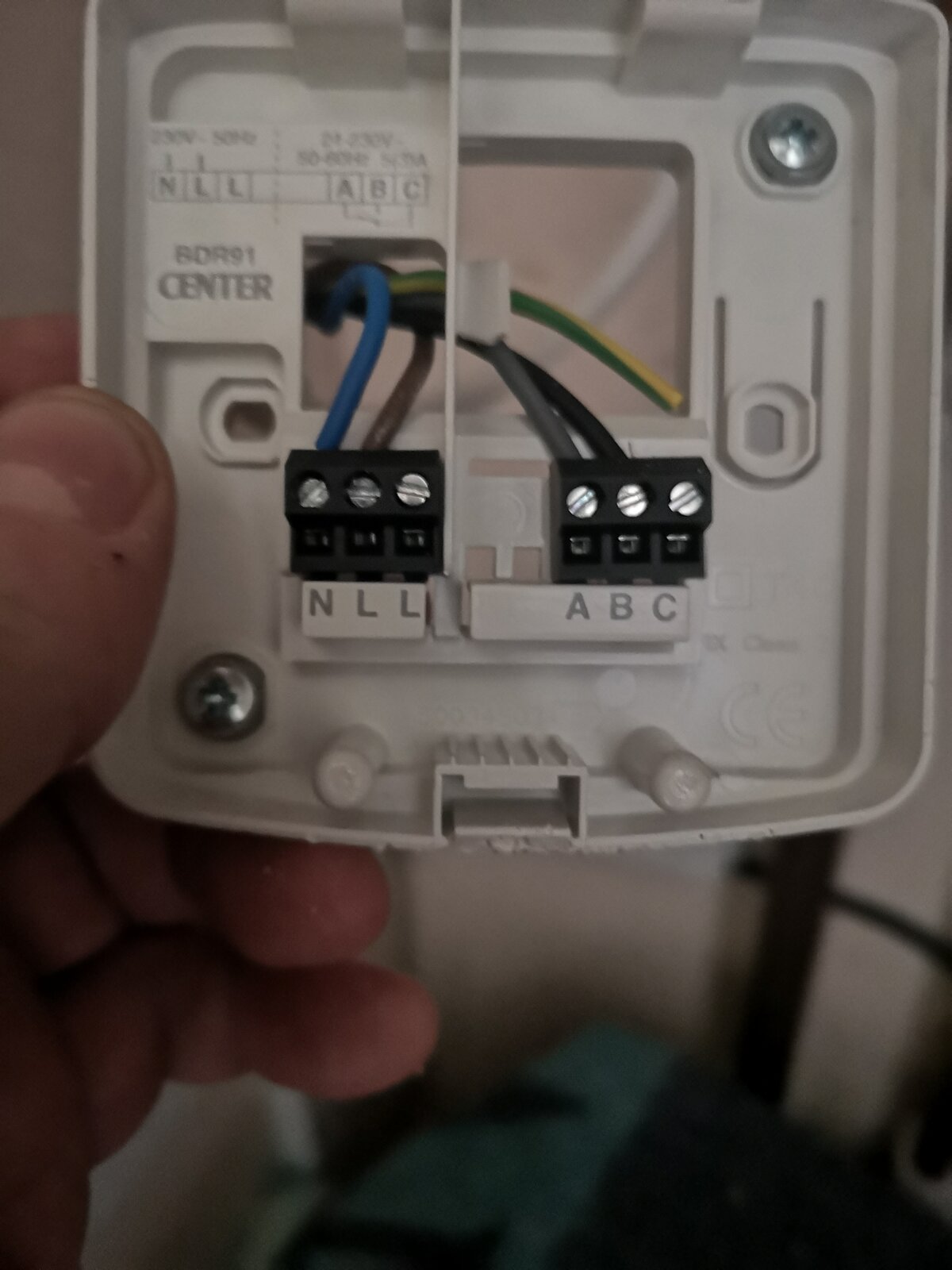

Just a quick question regarding my hive receiver wiring. I've switched over from a center wireless to a hive.
In the center receiver the earth was never used so when I wired up the hive I did not connect it.
I put the live and neutral in the obvious place and the grey into port one of the hive and the black into port 3 but not connected the earth. Everything is working as it should but should I connect the earth. I'm not sure if it's connected in the boiler or not.
Second picture is not mine it's one I copied
5 core heat cable from a fused spur connect to the boiler
Any help appreciated

I’m led to believe it’s there for testing purposes (for electricians), the hive will be double insulated and doesn’t require one.
Thanks Chris
My worry is that the second picture shows the earth connected. But this was just a picture I copied.
In my first picture that was my old center set up and as you can see the earth was never used.
