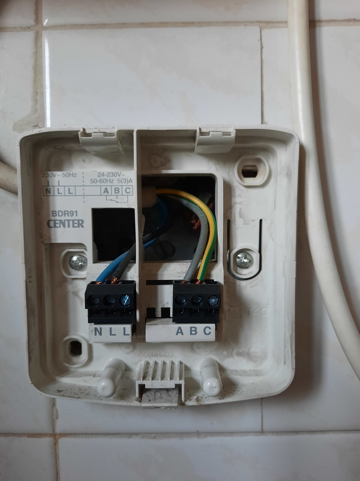

Hello,
I've pored over the threads here and I'd like to ask if I've got my wiring right before I go ahead with switching my BDR91 heat link to the one with the Google Nest (Gen 3).
This is my BDR91:
This is the Nest wiring diagram:
Based on this should I connect it like this:
BDR91 (L) = Nest (L)
BDR91 (N) = Nest (N)
BDR91 (A) = Nest (2)
BDR91 (B) = Nest (3)
What's throwing me is the earth wire used at BDR91 (B). Is it an earth or have they used the wrong wire? It's a combi boiler too.

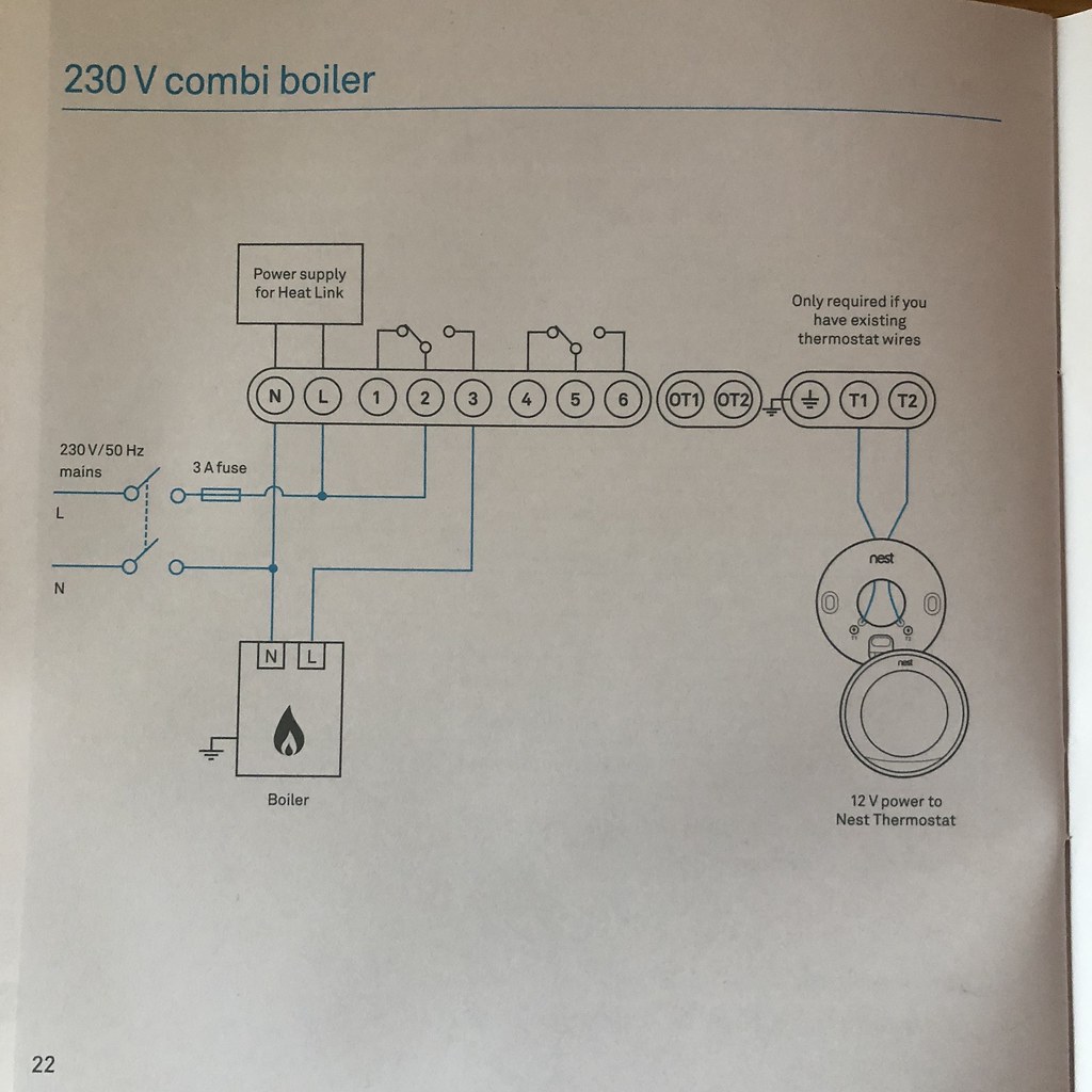

![NEST 3 COMBI.jpg NEST 3 COMBI.jpg](https://cdn.diynot.com/data/attachments/221/221657-dade4c57e20869b47376fb027f4f7c70.jpg)
