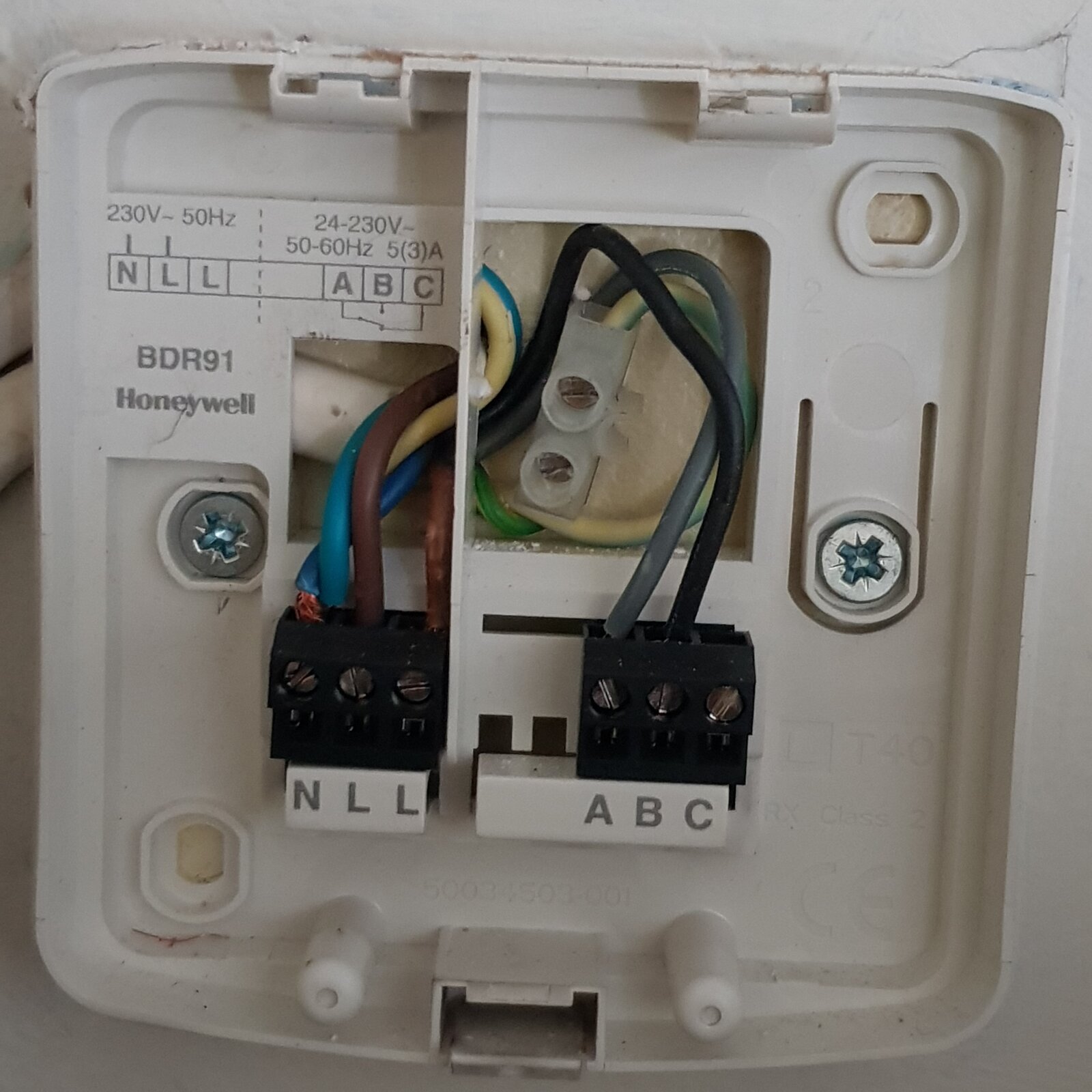

Hi all,
I have read through as many similar posts as I can in regards to my dilemma, I couldn't see anything that was similar to mine.

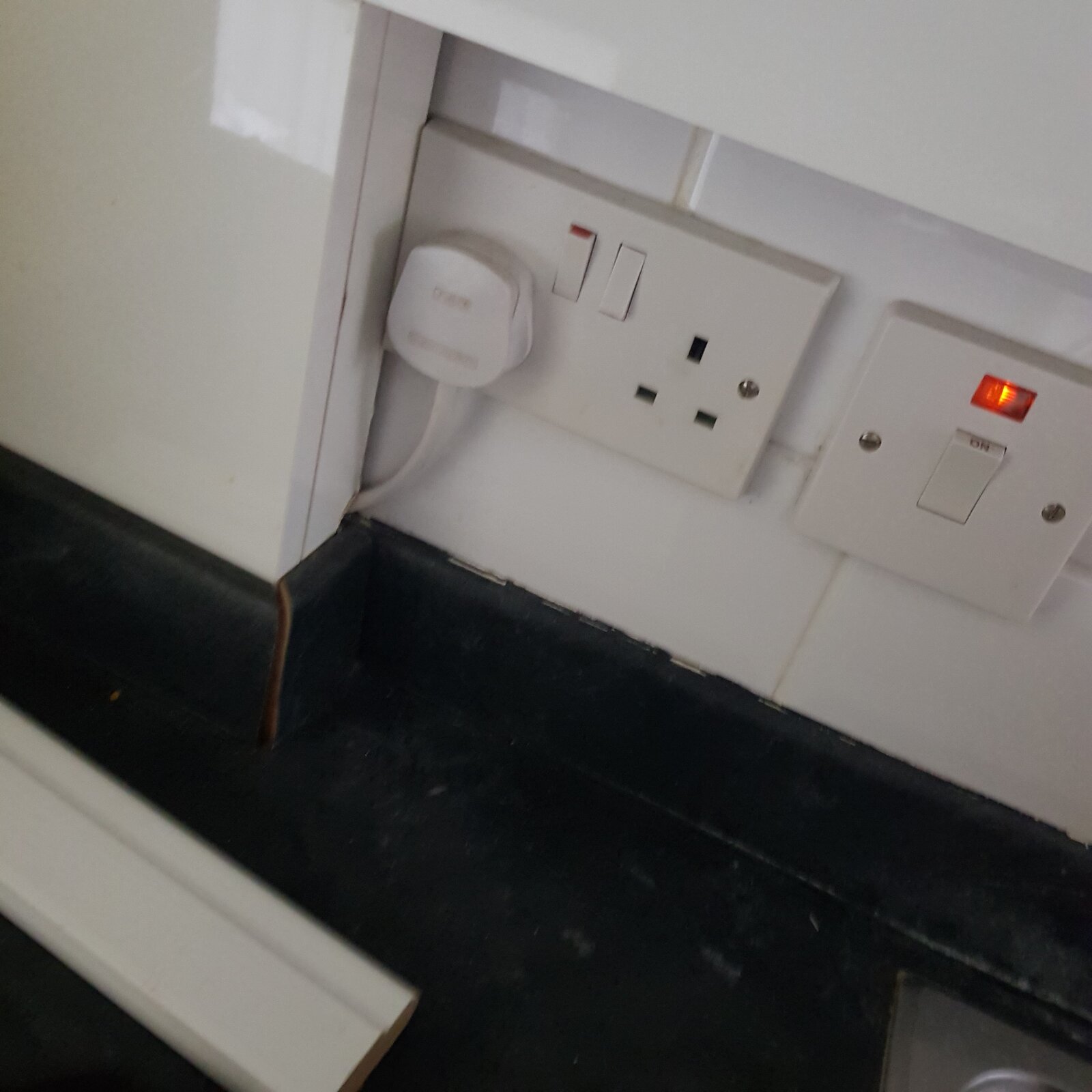

I have a Vaillant ecotec plus 837 with a Honeywell BDR91 and CM927. The vaillant is connected by a UK mains plug as opposed to it being hardwired with a 3amp fuse at the terminal block.
I want to replace the Honeywell BDR91 with a Nest Heatlink I have attached some pictures of the current wiring l.
How would I re-wire this to the nest Heatlink?
There seems to be 2 live and 2 neutrals. I get the A=2 B=3, but I'm stoked as to he 2 live and 2 neutrals wires

You are correct about a&B to 2&3, but as for the lives and neutrals you will just have to follow the cables and see where they go, as for the plug that is bad and needs sorting
