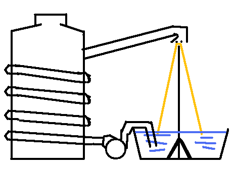

Knowing my fridge/freezer is some 20 years old I have been looking at what to replace it with. I have been looking at the Thermoelectric Peltier Semiconductor Refrigeration Water Cooling System,
I don't like the peltier system as it is very wasteful, but it is only for when the weather turns unexpectedly hot. I could dispense with the peltier and simply use a container of cold water, it is not the cooling of the water I was looking at but the ability to turn a water pump on and off. Using a water pump means I can use a temperature controller to turn on the pump when hot and turn off the pump when cold. Now I am looking again at the latent heat of evaporation, if the water is returned to run down a bit of towelling specially with a small fan aimed at the towelling then the return water can be cooled to less than ambient as long as humidity is not too high.
Problem is I am lazy and likely will not bother building a unit until my fridge/freezer fails. But thoughts please, would it likely work?
