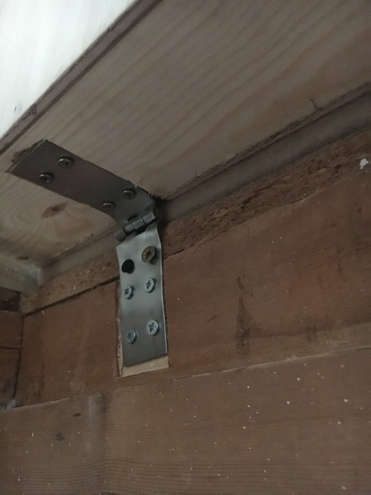

Hi all, just putting in a hatch in my garage, hatch is only about 10kg, however I've put a hinge down one side, herein lies the problem, the loft has 20mm of chipboard so it's pretty much unsupported, I thought I would use a backflap compared to standard door hinges (so the screws are further away in better wood), however the metal in the hinge is bending causing the door to jam. I'd putting in some extra holes (and tried to put screws through at an angle in the chipboard to try and grab some decent wood) Any suggestion hinges?! To solve this?
Think just some Strong hinges may help!?
Edit:
I should ass that at that corner I have a gas spring to help open the door which is probably pushing on the hinge when it opens
What do you mean? Is this a hatch in the roof or the wall side?
Oops.. those hinges look flimsy!

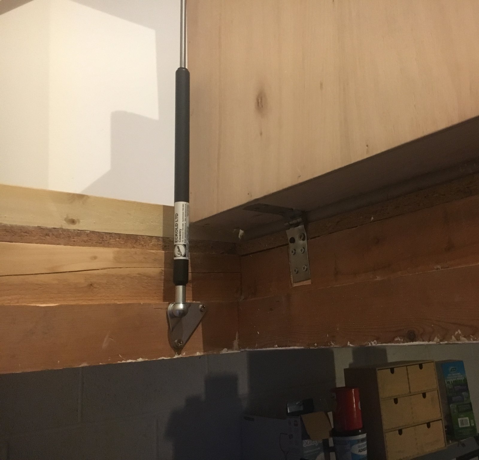

Possibly, but i can't envisage what you're attempting to do, so hard to say! Zoomed out picture to show the surrounding area?
Hi, it's a hatch in the floor, so the gas spring is to help support the weight (and keep it open), here is an image taken slightly further out (hatch is open)
Replace the hinges with stronger ones and this time set the hinge into the joist more.
Otherwise it will eventually fail and the most awkward time and be a right PITA.
Hinges are mounted incorrectly the pivot point should be above the flap straddling both frame and flap.
Yeh, the pivot point is (or rather was!) slightly above the flap (although I made it fine and did need to trim a little at the corner, you can see the metal has bent and is now below that level. Agree that it is a tad proud of the floor side.
So my resolution, a nice fat fire door hinge (3.5mm thick metal)z I also pulled up the chipboard about 10cm either side of the hinge and put in some decent wood so that the screws would h ave something to bite into.
