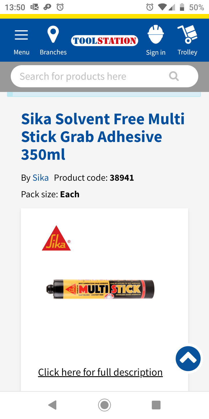

I used this:

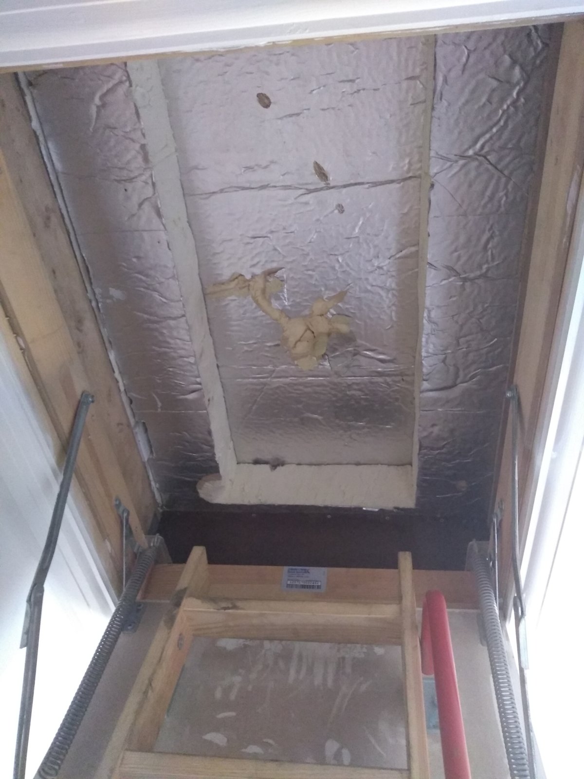

I actually did make a box from celotex (it covers my loft ladder). No problems and it gets a fair bit of knocking around.
