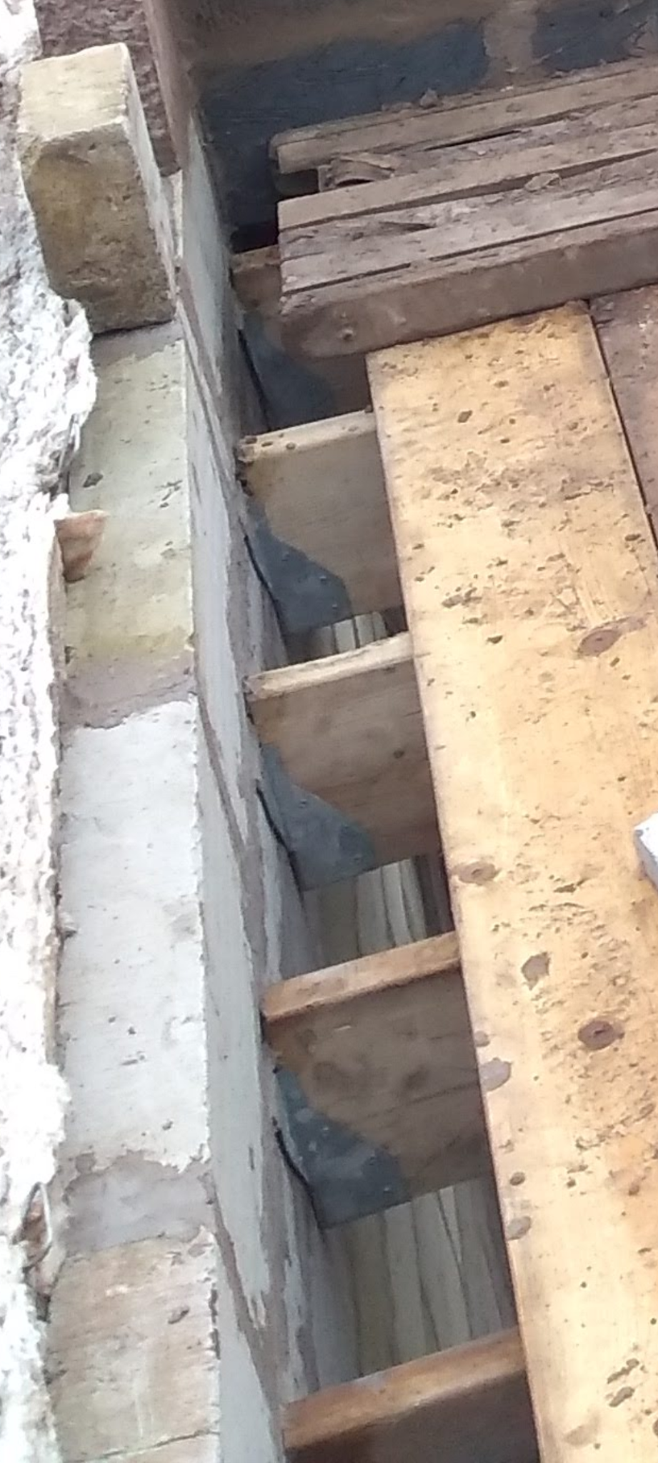

Avoid resting heavy joists directly on the lightweight block, use a continuous timber wall plate. You bolt and resin-anchor the wall plate horizontally along the Thermalite wall, and then face-fix standard hangers to the timber instead of the block itself
I use masonry hangers. I know people do it, but the idea of my floor being held up by a dozen bolts stuck in the side of the building equivalent of Weetabix bothers me.

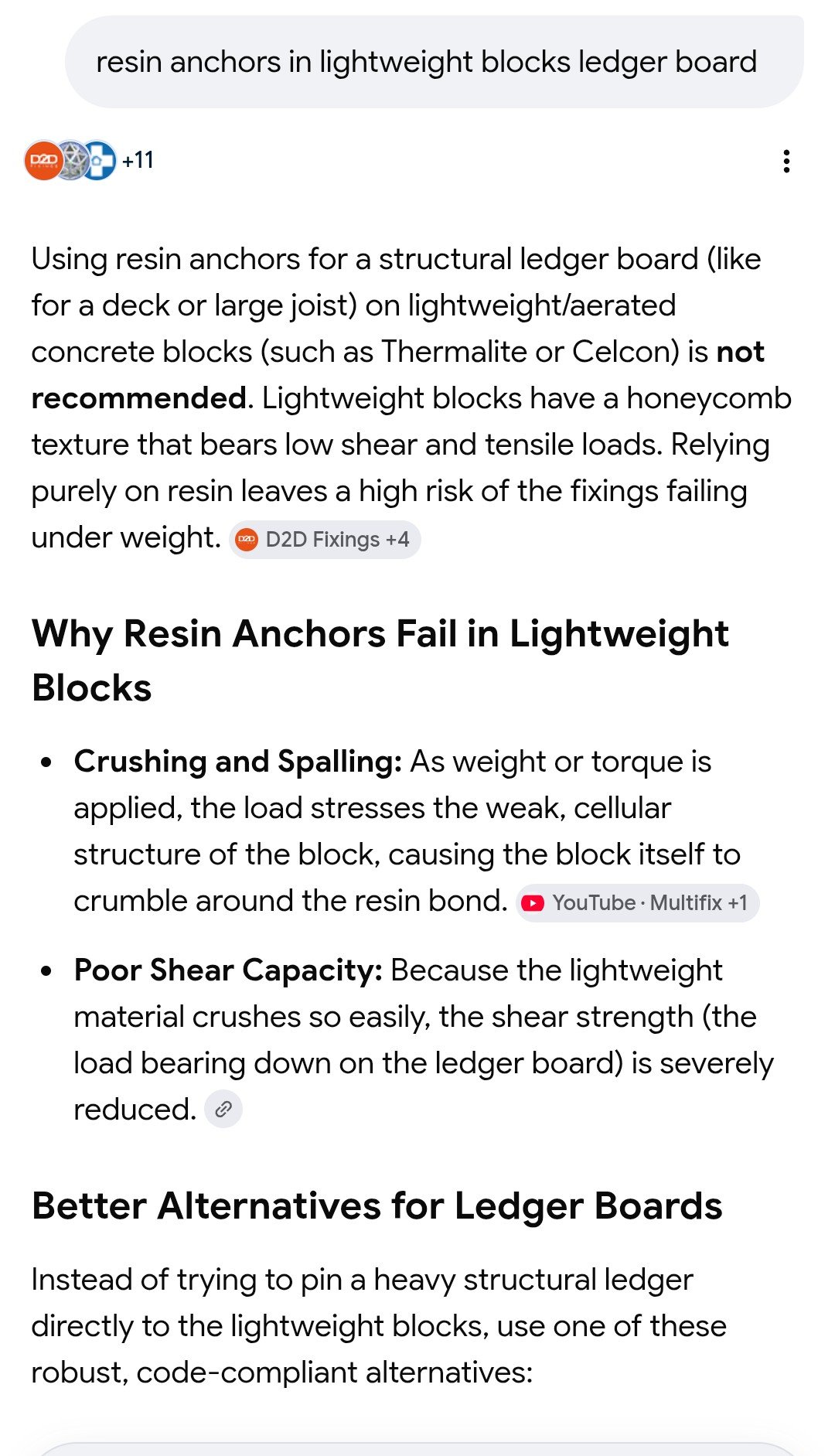

Here's some AI waffle which may or may not be true:

4x2 C24 Plate bedded on mortar on top of the celcon blocks to achieve a level surface, then wall straps at no more than 2 metres apart, wall straps can be hidden by dot and dab plasterboard if that's the wall finish.
