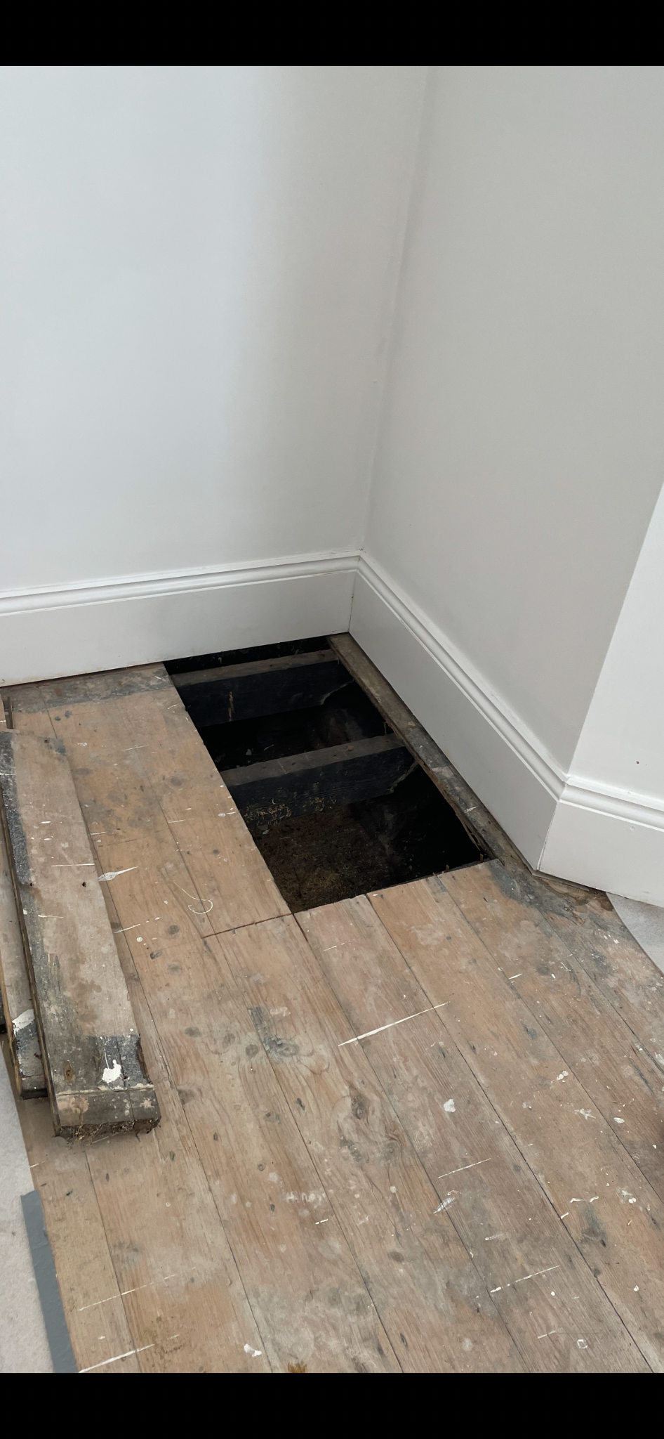

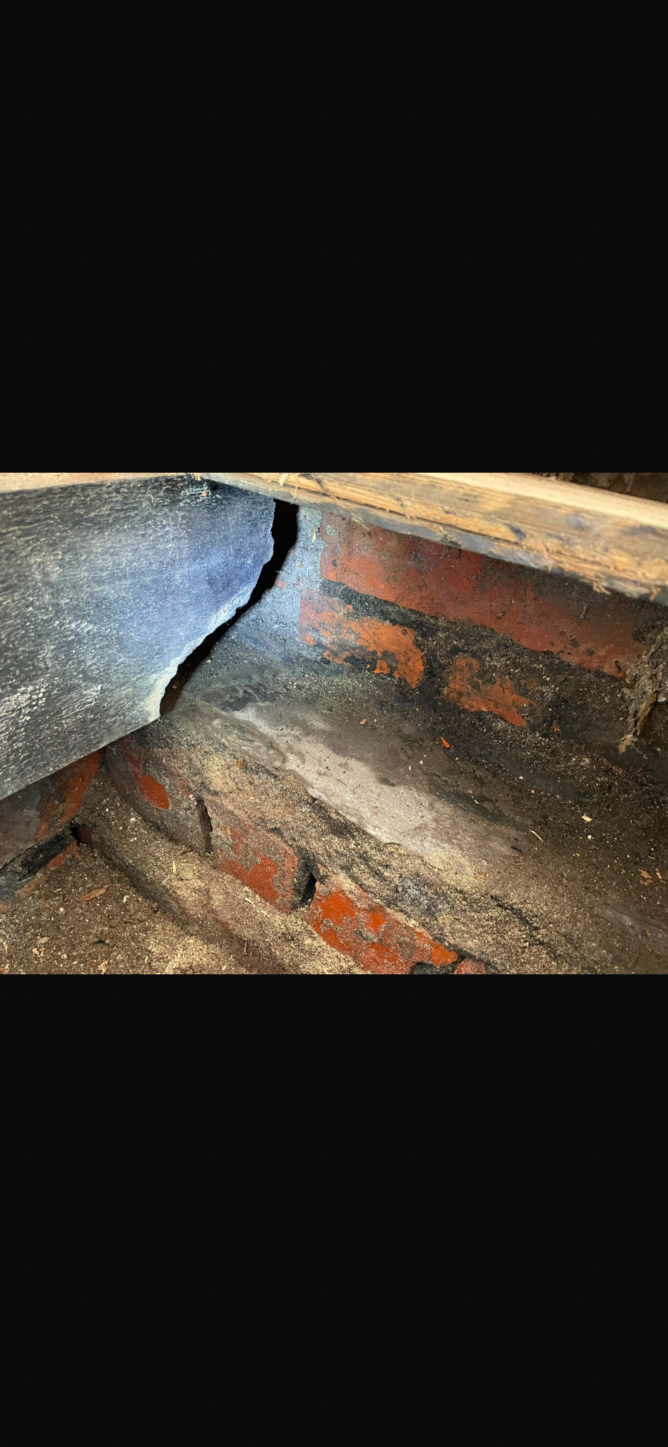

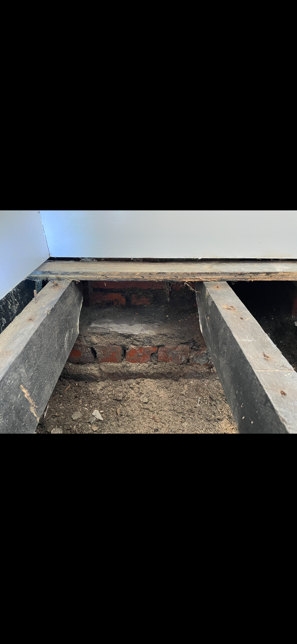

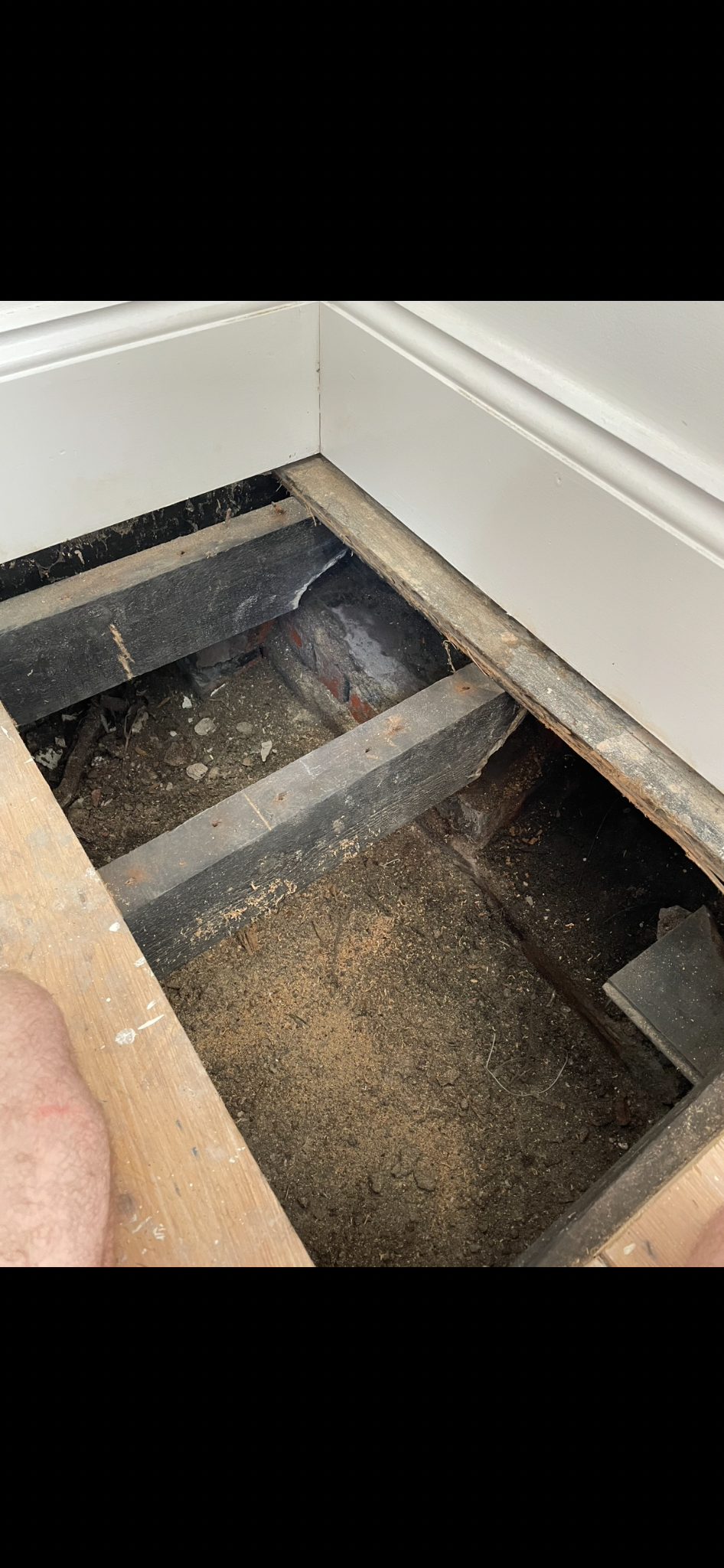

Hi
Ground floor Victorian house, floor joists rotten in corner to front elevation. What’s the best method to resolve?
Thinking of sister jointing. Would appreciate views on this. The rot appears localised at the joist ends due to a leaking downpipe I suspect.
I was thinking maybe I don’t need to cut the existing damaged joists too far back as the sistered new wood would be resting on the pier and bolted to the joists.
Thanks in advance

You could sister but put some dpc on brickwork , you could also put a brick on the ground directly below and drop legs of timber down to it and a noggin to next timber to prevent any movement.
