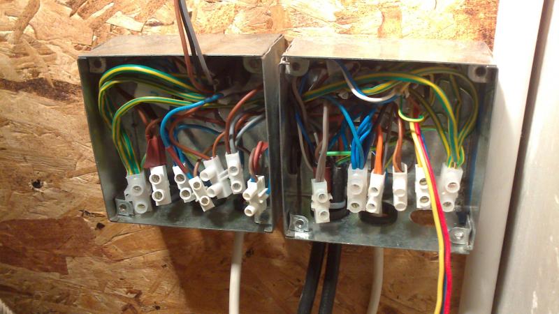

Hi, I'm making some modifications to my central heating and hot water system in a cupboard. The old 'wiring centre' was a single gang plastic pattress box, which was pretty scary and literally crammed full with wires. Conventional wiring centres don't have enough space, so I've put in two 100x100 adaptable boxes next to eachother which gives plenty of knockouts and wiring room to accept flexes from valves, pumps e.t.c. at the bottom, with the T&E from thermostats, programmers boiler e.t.c. coming in the back. I'm trying to do it as neatly as possible, I'd have rather used one large box but there simply isn't enough length on the existing cables, so I opted for smaller boxes with shorter terminations.
I still have 8 flexes I need to terminate: two motorised valves, 2 circulator pumps, a flow switch and 3 thermostats. At the moment, I've connected all the neutrals and earths using large 30a choc blocks, but I'm going to have an extra 5 or so more wires to connect together and I also need to bond the boxes. Is there is a better solution to connecting multiple earths/neutrals in junction boxes? I've considered the 5-way lever wago connector, but I'd need about 3 of these, so maybe one in each box. Any thoughts? Also, do you think another 100x100 adaptable box might be needed for the last few accessories?

Well, You can use both sides of the connectors.
I think it would be preferable to have a row of connectors (not separated) in the middle (vertically) of the boxes with some semblance of order so that they match a diagram as much as possible.

You can have two blocks linked together.
Also, are your two earth blocks connected to earth and each other?
Plus, the boxes will need to be earthed as well.
Problem is, there's no slack on the existing cables, and there's only a short amount of wire to work with, (the wires aren't long enough to be spaced out in a conventional big wiring centre you see), that's why I'm using two or three smaller boxes. Yes, I have connected the earths in each box with a link, and plan to bond the boxes. I was thinking of using one of these http://www.toolstation.com/shop/Ele.../Schneider Easy9 Earth Kit/d190/sd2901/p11412
screwed to each box, but I ideally need an insulated version for neutral, but can't find anything like that
WAGO connectors available in sizes from 2 - 8 ports.
the type that accepts stranded cables is a maximum of 5 ports. However, it says each port can accept a 4mm cable. Would it be feasible to connect two 0.75mm flex cables into each port do you think? It would be very neat for all my neutrals/earths, but not sure if you can do that
With so many connections I would use something like this.
Din rail mounted terminals can have link bars so no need for any more than one wire in each terminal. Also means plan only has to count from one side even without numbers on them.

this is what I'd ideally like to use, but there just isn't enough space in the cupboard for a huge box, and the cables aren't long enough. I hate my life.
