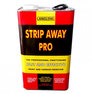

Look at the ingredients and compare with others brands.
Not one I heard of
Old school nitromors contained methyl chloride. MC was banned from DIY products because it is carcinogenic. You can still buy it but I believe that it must be sold in 5L containers (and larger).
If you google "methyl chloride paint stripper" you will find people willing to sell it in smaller quantities but I do not know if they are doing so legally, and hence will not provide links here.
