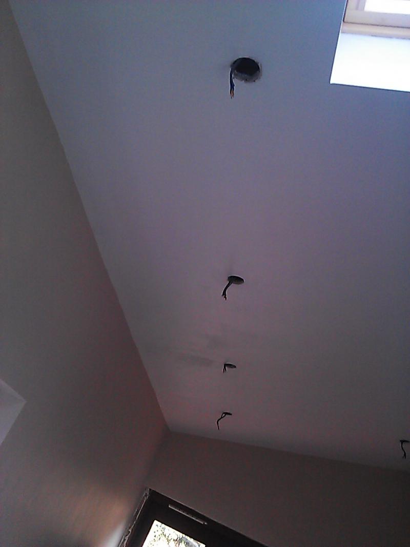

I've had some downlights fitted but to cut a long story short, they're the wrong ones.
As the ceiling is on a slope I need adjustable downlights, however the hole for them needs to be 85mm instead of the existing 72mm
What's the best way to enlarge the hole? Will I be able to use a hole saw as there won't be anything for the arbor bit to grip into in the middle?
Your best bet is to mark 6.5mm with a pencil around the the circle giving you 85mm overall then cut it out with a pad saw job done.
Or cut a plasterboard or wood template, hold this against the ceiling and drill through this.
Both ways will work, I'd opt for the mark round and cut out manually, not sure if 72mm + 6.5mm is 85mm though ???!!!
6.5mm around will equal 13mm extra to the diameter so should be spot on
Put the 72mm hole saw cutter inside the 85mm hole saw cutter so then you are using it as a guide there should be enough thread on the arbor to do it.
yes that will work but pad out the 72mm as much as possible with washers so it will be as far through the board as possible so the teeth are clear and the body will guide it through

Pad saw will do the job but a good tradesman will just load the arbour with two holesaws. One guides and one cuts.
Most arbours will allow that.
