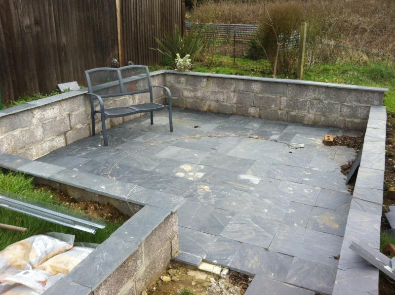

I have built a patio surrounded by block walls with slate paving. I have used small pieces of slate to cap the walls however the mortar that i laid them on was not enough as over the winter they all became loose.
What is the best thing for laying these? bear in mind they are all around 2 foot high so are likely to get sat on! Someone suggested that i should use tiles adhesive which they have had with some sucess but any other ideas?

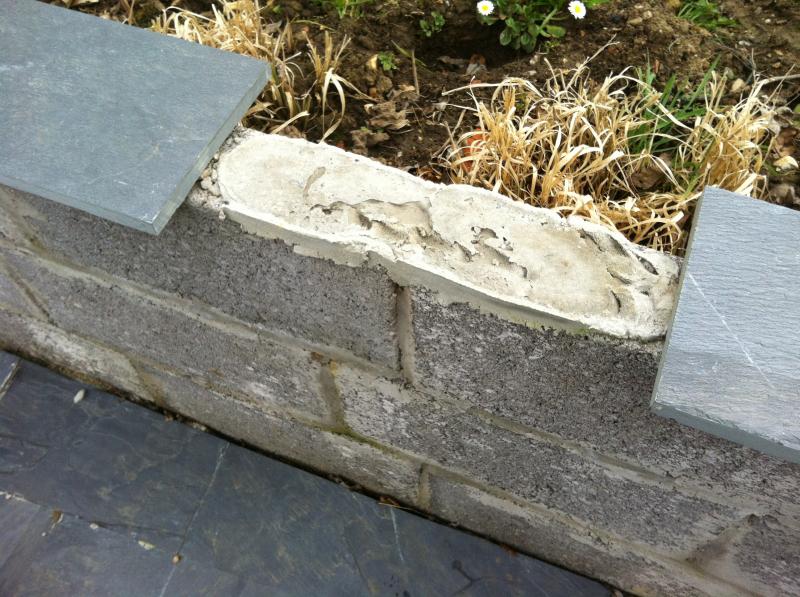

You need to prime the back of the slate with a sbr and cement slurry as mortar will never stick that well to slate. If you do it like that you can lay them on 3:1 building sand to cement with a splash of sbr in it.
Alternatively tile cement.
Its a bonding agent, its sort of like a waterproof pva for use outdoors, it increases the 'grip' and strength of mortars and renders.
Tile adhesive would give the best grab and if you havce already bedded them down the bed should be perfect for a nice thin 3mm or so of a good quality natural stone tile cement.
As i said slate paving is notorious for not bonding to the mortar which on a patio is not a problem but on steps or walls it is.

Sounds good, I'll score the back of the coping with an angle grinder as well to try and give it a bit more adhesion.
So you simply paint the layer of slurry on and, while it's wet, bed it into the mortar mix?
That's what I did (minus the bit about the angle grinder).
