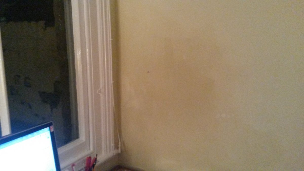

I currently have a small amount of rising damp and a small amount of what I would call lateral damp coming into my 1890 mid terraced house from a rear garden wall.
I have had different advice off builders/damp proof specialists on the best way to deal with the damp.
Guy number 1 wants to inject chemical damp proof course, strip back to brick and render/plaster with required chemicals to prevent salts coming through,etc.
Guy number 2 wants to strip back to brick in both cases of damp and use plastic membrane to contain damp followed by plasterboarding. Guy number 2 is significantly cheaper and will not use a damp proof course stop the damp coming into the house.
Any experts on here with a suggestion to what is the best way to treat damp?

Ok. So the first pic shows the lateral damp and garden wall through window. Damp is not rising from floor. No pipes by it, etc.
Second pic shows example of rising damp. Spoiled paintwork,etc.

Thats the problem I guess nowing who knows what they are talking about. Interestingly enough the youtube guy mentions peter cox and tanking. A surveyor from peter cox surveyed my house a while back and said it was rising damp in Pic2. Pic1 he said it was natural for damp to come into the house via garden wall. And we needed to go back to brick inside where damp is and tank wall. He said not to bother with vertical DPC on garden wall and just put some more coping stones on top. I thought he knew what he was talking about.
Still none the wiser on what to do to be honest. One thing for sure hacking back to brick and leaving to dry out is probably not an option for me.

Try disconnecting garden wall from house and leave an air gap the wall could be pushing moisture into your house
"disconnecting the garden wall" would be the way to go. A gap could be created and a sheet of DPC material slipped in. A buttress could be built to give stability after breaking the abutment.
"coping stones" are necessary but, given the garden wall and the house wall are probably sodden by now, copings will only provide a little relief. A lead saddle will also help.
But first the OP could inject a vertical DPC into the garden wall just before it abuts the house - injecting from both sides of the garden wall would be best.
The thing is, injected DPC's are mostly hit and miss so it would be a wait and see experiment.
We dont know if the house or garden wall is rendered or the state of the pointing.
Its quite possible that you have penetrating damp thats rising?
