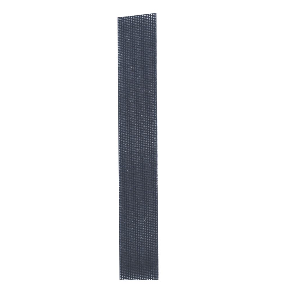

Peel Tec. Going to have to give it change to work then scouring pad
