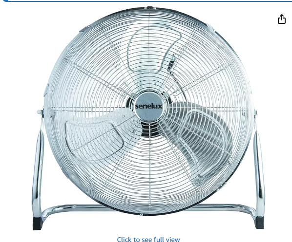

thanks for comments. source of water we think was a leaking pipe inside the electric shower unit on the other side of the wall. I've got a very good plumber who is excellent at sussing out leaks. So, as you can imagine every time someone had a shower water escaped into the wall. My plumber changed the joint and the shower has not been used for about a month. I wonder if it is just so saturated it is taking time to dry out. That said, when we have had new plastering done it has started to dry out after a couple of weeks. Using a dehumidifier hasn't helped & it's a ground floor flat. Is a saturated wall more difficult to dry out that new plaster?
Summer fan. You don't need heat just air movement to dry it out. Just like washing on a line when the wind is blowing
Ha. Don't half blow those. I use to dry out paint ect so I can crack on
