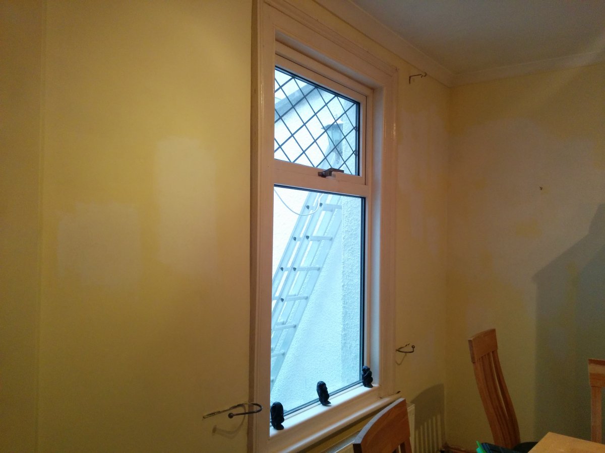

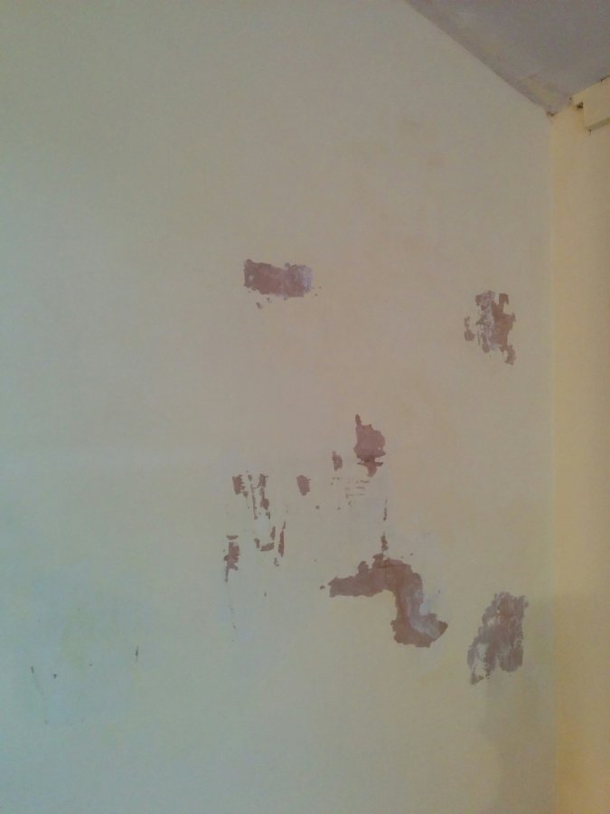

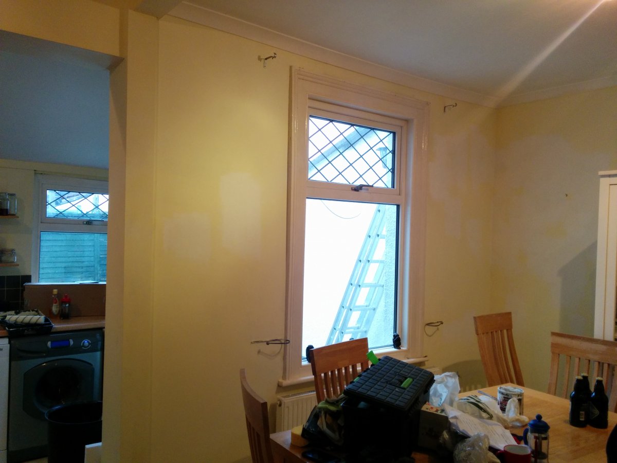

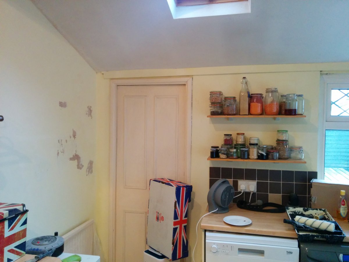

Thanks big Wayne, I'll try and get some pics up later. It's on the ground floor at the rear on both the party wall and the wall with the window facing the outside. Its mostly about half way up and in the top corner of those adjoining walls. Outside we found a gap in the stone parapet slabs between our wall and the neighbours where rainwater was clearly getting in, right where the corner is for the ground floor - that's been fixed. Dave
Hi guys, here's some pictures for context. The walls that have white patches I think will be ok, but the wall with the missing paint patches just peels if we try to repaint it. As I said, we've done the exterior work to rectify but the walls don't seem to be dry yet... Not sure what the best option is for the next few months while the house is rented...
