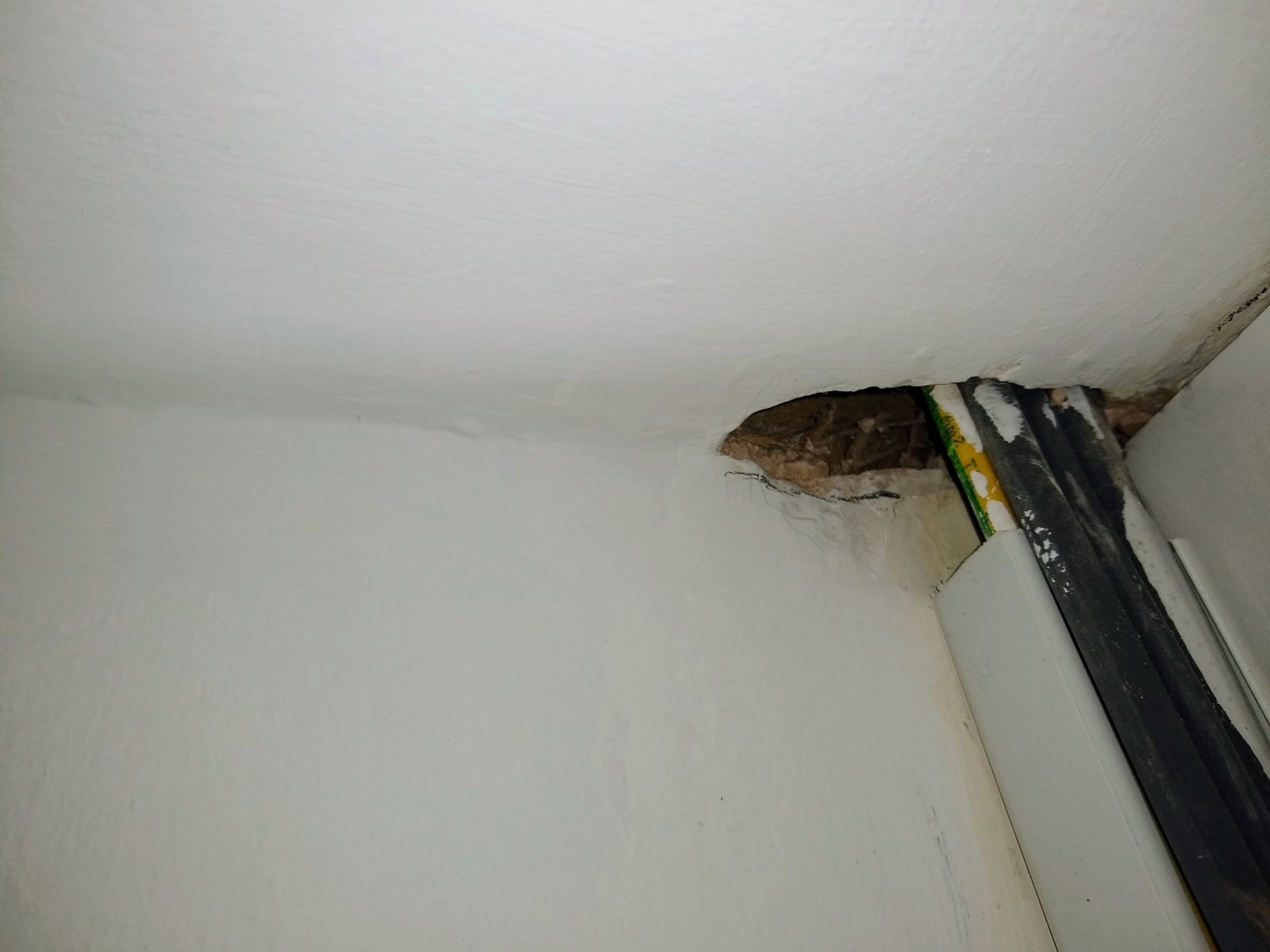

Electrician made a bigger cutout in ceiling to feed some wire.
Could someone advise on the best way to make good?
The gap is 30mm wide and 20mm high

Decorators trick scrumple up some pages of the " Sun " Newspaper ( or if you are posh, Kitchen Roll) wedge it in hole fill with several layers of Polyfilla, rub down when dry and paint , wedge in small section of trunking or replace complete length . .

Top man!
I'm a classy lad so I'll be using kitchen roll thank :D
