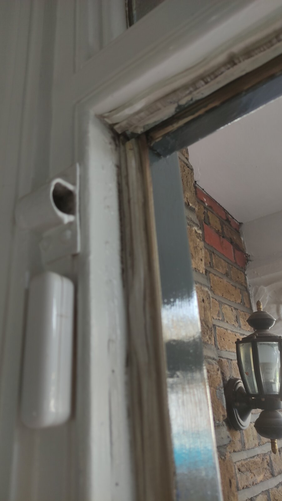

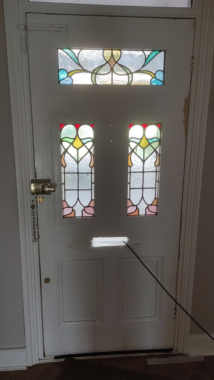

Here you go, attached.
You can see it's got bits of foam/rubber there at the moment which as I say, is okay but not very neat

If you can aim for a maximum 3mm gap up the sides and across the top (like on a fire door - in bad cases on old doors this can involve lipping a door then rehanging it), router in a compressible rubber weather strip (such as Schlegel Aquamac 63) around the sides and top in the corner of the rebate (or use a mechanically fixed equivalent), fit an automatic drop seal at the bottom of the door (either routed in - better - or surface mounted - not as good) which will be far more efficient than a brush strip (they are designed for acoustic and intumescent sealing in many cases) and consider some form of weatherproof threshold on the floor at the bottom if it is uneven. The letter box also need to be a sprung flap outside/sprung flap inside type oreferably with a brush seal on the inside, although having an external (say wall mounted) post box and blocking off the letter box opening so you lose that girt great hole in the door is always going to be a greater improvement. You may also want to consider surface mounted secondary glazing behind those glazed panels as they are large cold spots and lead often leaks heat out. Finally, there is the old Victorian solution of a pivoting curtain pole with heavy, full height curtains added behind the door. AFAIK that's the full Monty :).
I'd say rebate seals (even nailed in ones), dealing with the letterbox opening, double glazing the leaded glass and a surface mounted drop seal would give you a considerable improvement without taking the door off
Any draught solution fixed to the face of the door is never going to perform as well as the inbuilt solutions you'd employ on a new door (which I detailed above), and IMHO will always end up looking scruffy over time (at least many of the ones I've ever seen). BTW, I can't see why the door won't come off readily, either - only two hinges, so 8 screws? (but then I'm a joiner)
