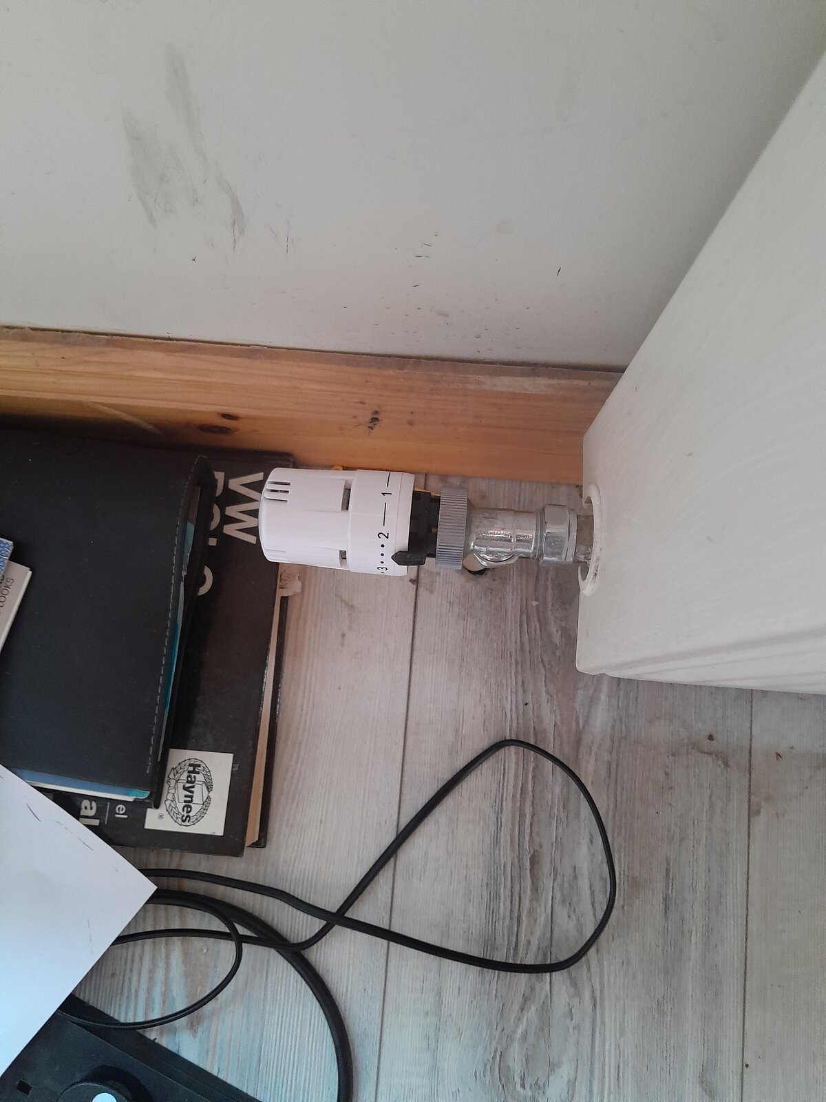

I installed 7 out of 8 of mine horizontally, (on the return.). This particular one replaced one which lasted almost 7 years but wasn't a EPH which I now use.

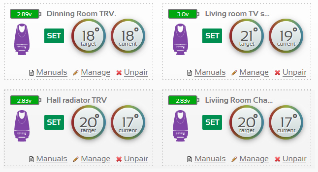

The TRV does display both current and target, 4 TRVs-1.jpg so that made setting up easier, I slowly closed the lock shield valve, until current never exceeded target, and once set, the radiator only got warm, not stinking hot, and each room was spot on what had been set. This was with a gas modulating boiler, so moving in here, I thought I know how to set up radiators, but no with an oil on/off boiler the TRV does not work as well, it still works, but not like they did with a modulating boiler.
The Energenie TRV head says it has two sensors one for water and one for air, so it can compensate for heat from radiator, the eQ-3 heads say how they detect open windows, and the Wiser say they work out how long to heat the room. Can't remember what Kasa said, but it does seem they are all different. Only the Wiser will actually turn on the boiler.

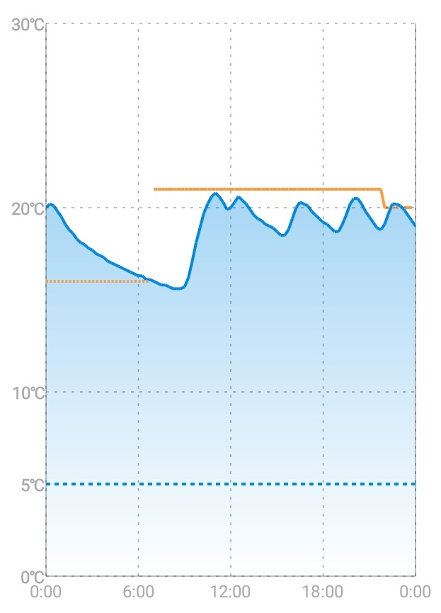

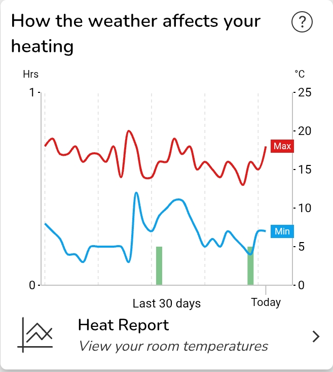

1749646137532.png the Kasa and Wiser 1749646223441.png both give reports, the Wiser one sorry the heating was not being used, however it does show any hysteresis, the Energenie and e-Q3 do not show a graph, and e-Q3 only shows target not current. However, they cost £15 each in 2019 with bluetooth so what do you expect for that price.
