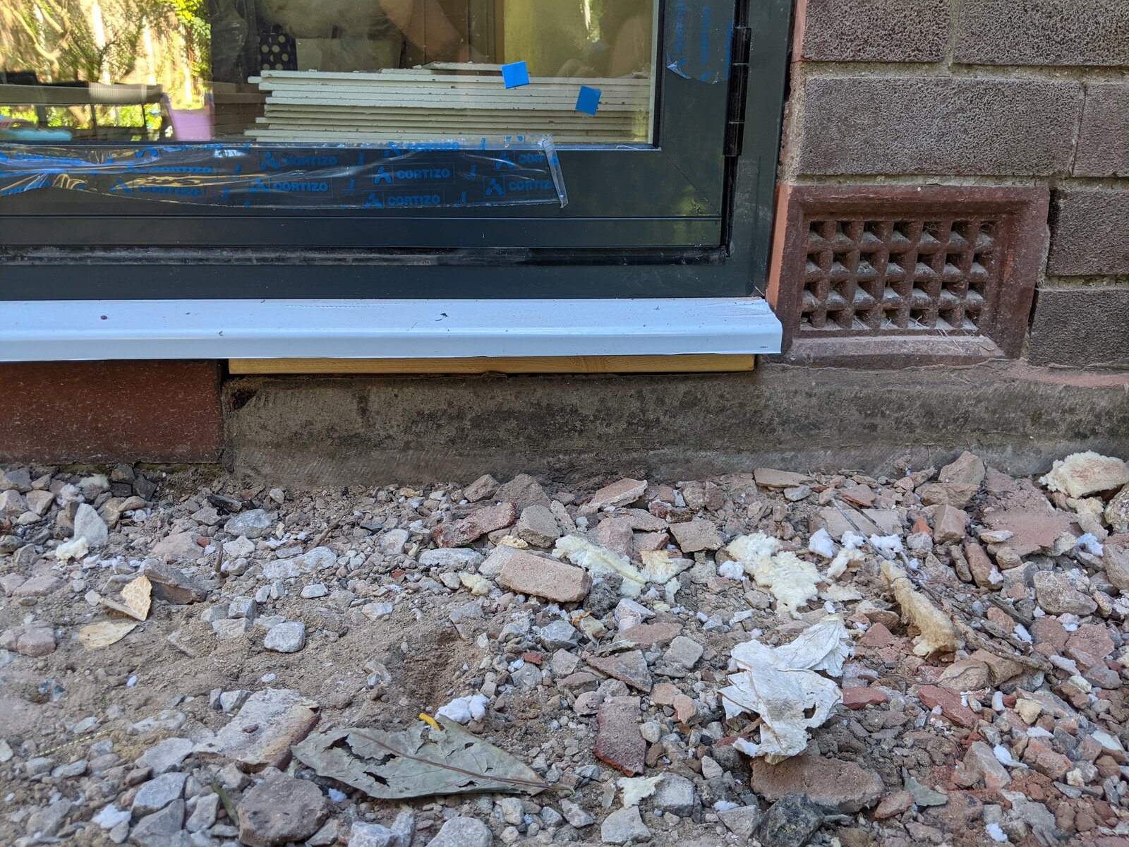

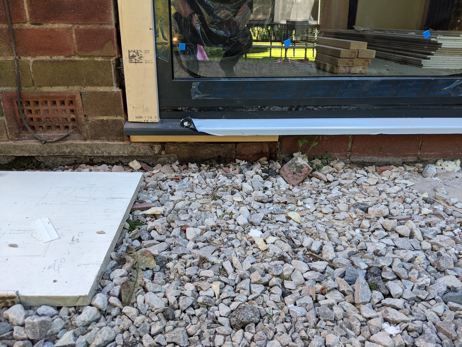

Hi all, hoping for some opinions please on an install of a bifold I'm having done by professional installers.
Came home yesterday to see that rather than brick below the bifold threshold they've dropped in a few pieced of softwood timber...I assume they couldn't be bothered bricking up to match the rest. I've told them I'm not happy with this due to softwood rotting, damp rising/splashing up and the fact it looks terrible. The solution today is to tell me they've sorted it....by cementing over and sticking a bead on..
Apart from the windows not actually working (apparently a part has been machined too big) this just strikes me as a bodge. Forgot to say, they've even attempted to grind the walls where the frame didn't fit too well and ended up cutting into the aluminium.
Am.i right to be concerned? Is this common practice to fill voids at ground level with softwood 2 X 1 and cover with a bit of cement and a bead?
Even the siliconing on a window they've installed is very slap dash for my liking. Am I being overly critical in terms of what is deemed a professional install? Thanks

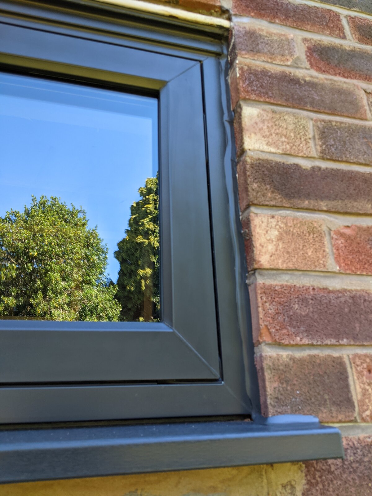

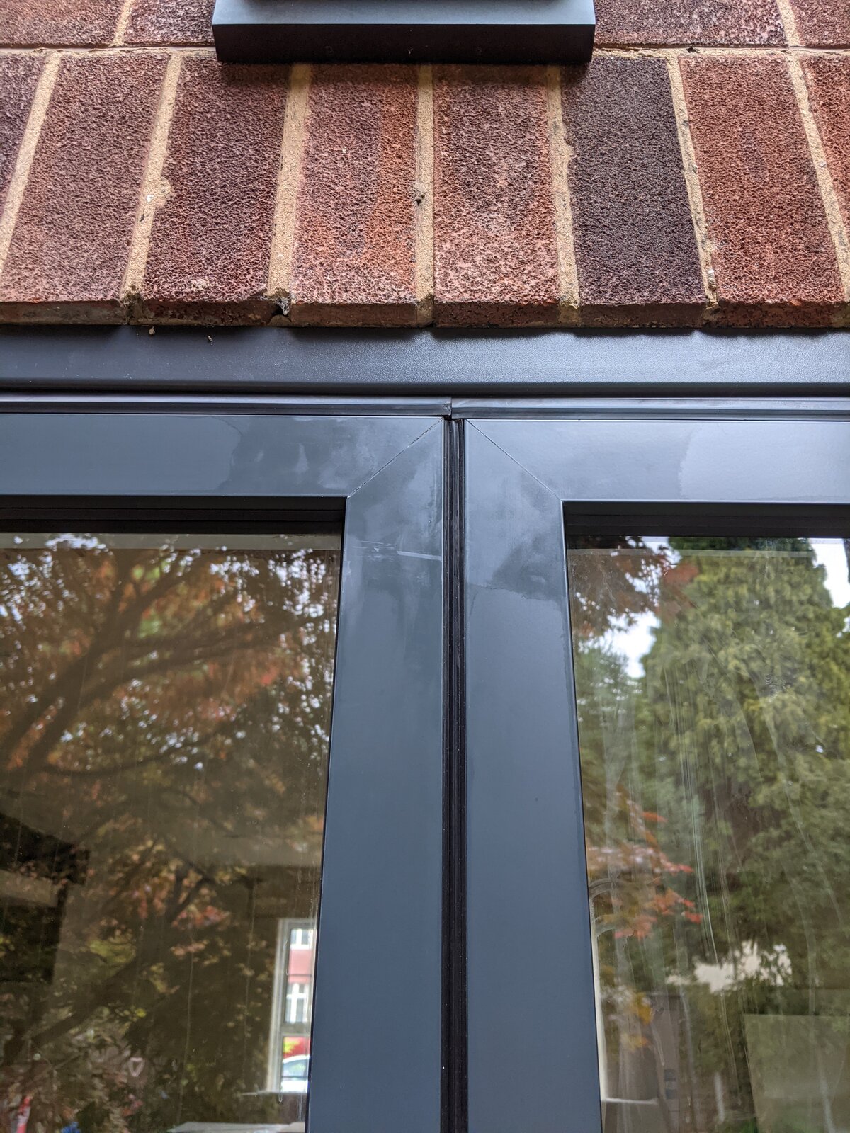

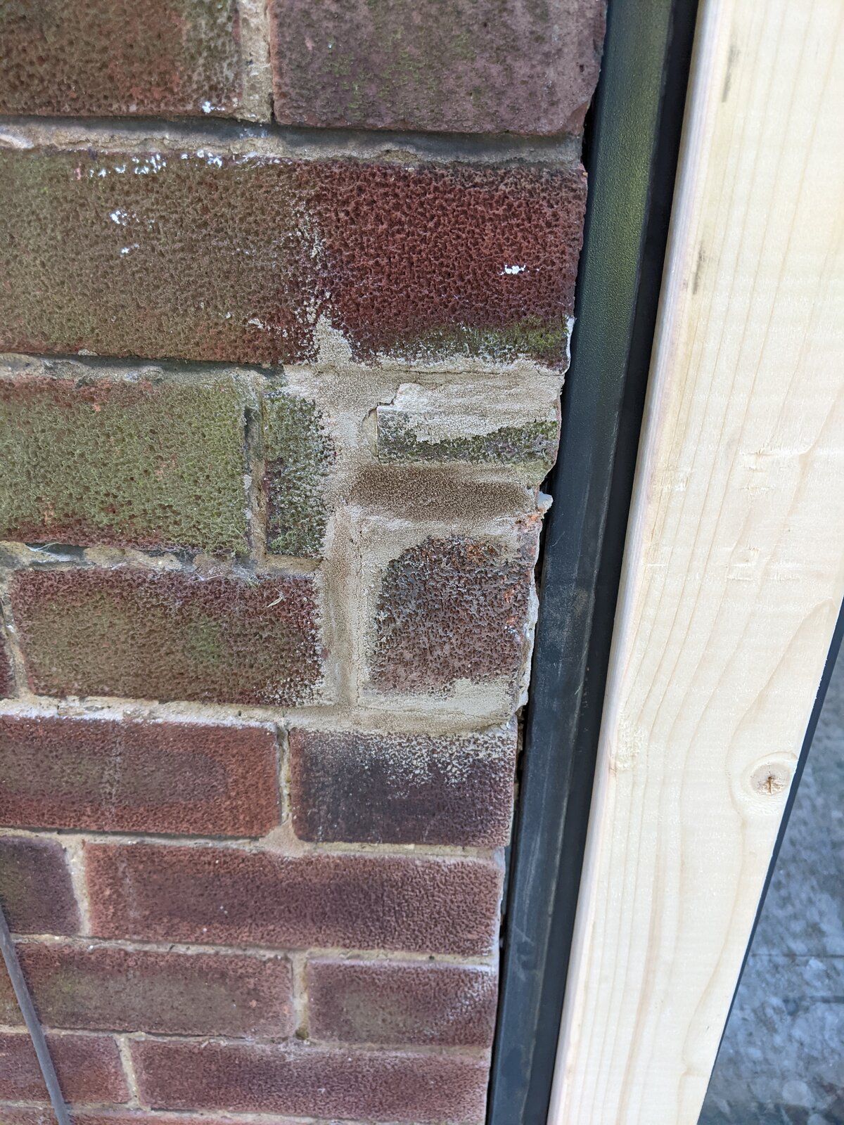

Forgot to attach these images of a bit of brickwork I asked them to fix and the siliconing..
.looks much better in the photo than in real.life.

Personally I would’ve fitted the frame in place by packing up the bottom with plastic frame packers, then filled the void with mortar, making sure packers are set back and covered.
the brick repair isn’t good enough, although unless there were some spare bricks around it would be tricky to make a decent job - the little Charlie piece and the other bits need removing then one then one cut brick put back in.
silicone is not really acceptable

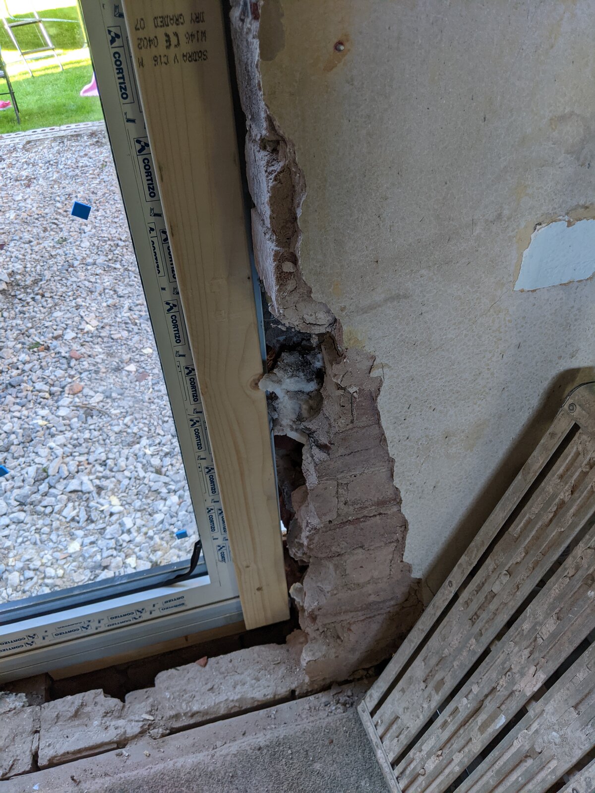

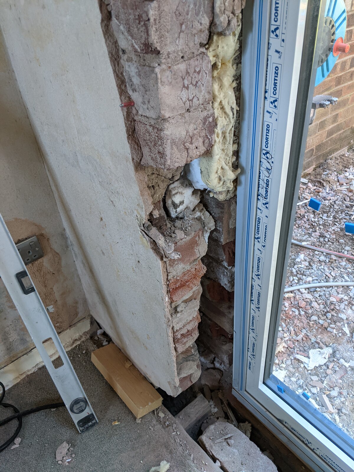

Hi notch7 I'd have been happier with plastic packers in the void and some mortar....I just can't accept softwood at ground level....amazes me how they don't even explain what the plan is....you go to work and comeback to see that. They had plenty of bricks too as they've removed some brickwork either side at the bottom which had windows sat on with a French door in the centre. Assuming they used a Stihl saw outside to cut the brickwork....should I accept this inside....seems like they've just hacked it off.

Will the wood underneath be OK, for a while yes, should it be there... No.
You need to get the installers back and refit properly. I wouldn't be happy if this was my house and it was left like that.
The brick pointing looks like they used their fingers to point it up, again this should be re-done.
It’s wrong.
they tossed in some softwood to get the frame wedged in place.
The correct way is to use wedges - even softwood is fine. They are used just to hold frame in place.
then below the cill, the gap is mortared in. Once set the mortar is what you see and what faces the weather.
Any suggestions on the way forward - what to realistically ask the installers to do? I do worry trying to fix a bodge may make matters worse
You need to politely but firmly write to the company by email, you need to itemise each part you are not happy about and ask them to do it correctly.
You can state you want it completed to a commercially acceptable standard.
