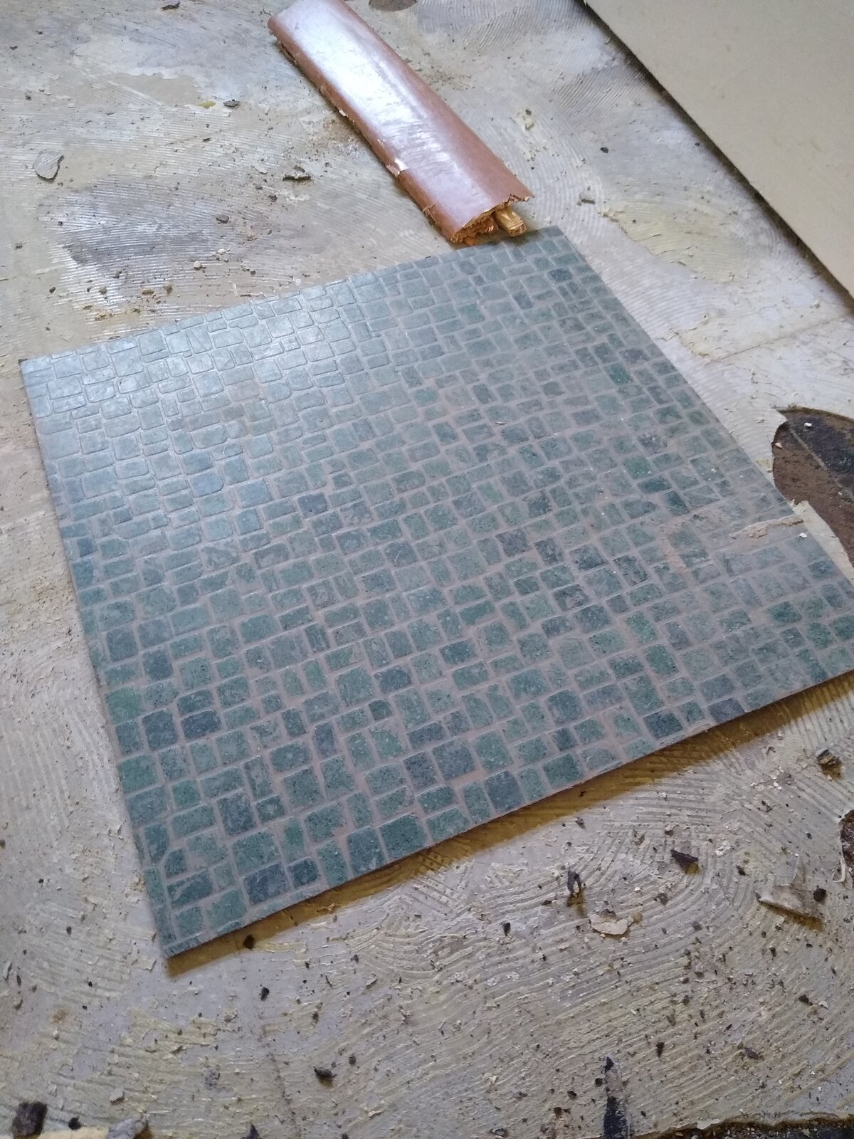

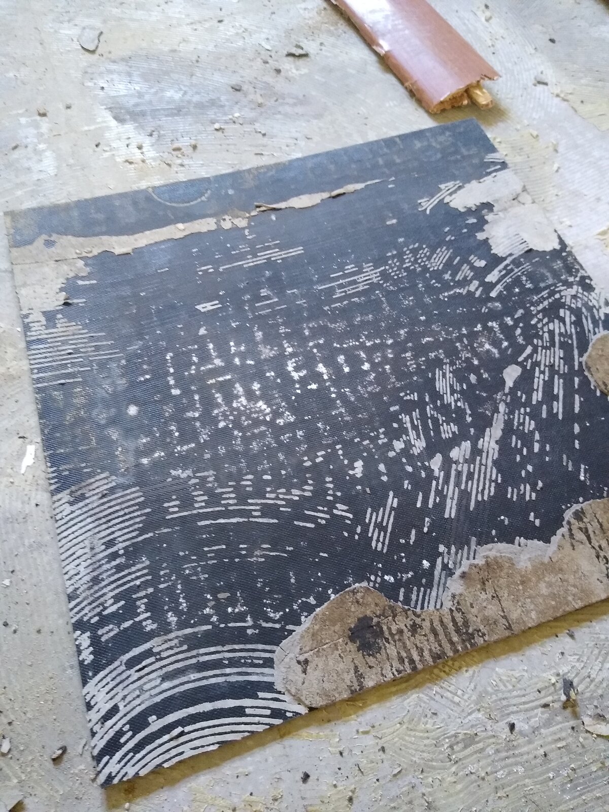

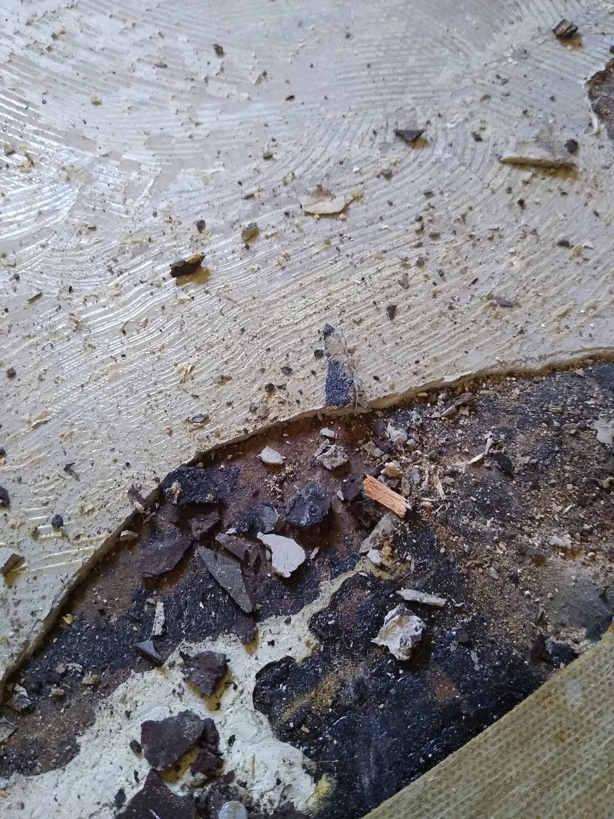

Hi all,
Refurbing a 60's ex-council ground floor flat. The kitchen and bathroom both have what appears to be bitumen vinyl floor tiles.
Looking for advise if I should be concerned about these containing asbestos.
I have removed some of the tiles. There appears to be some sort of adhesive underneath. Any idea if this could contain asbestos?
Am i safer leaving and tiling over?
These will typically contain a very small amount of chrysotile (least hazardous) in the tile and the bitumen adhesive.
Ventilate and try and limit any breakages. Or leave any that are firmly fixed
When working with those kind of products, misting them with water helps to reduce the risk of the fibres becoming airborne.
