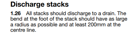

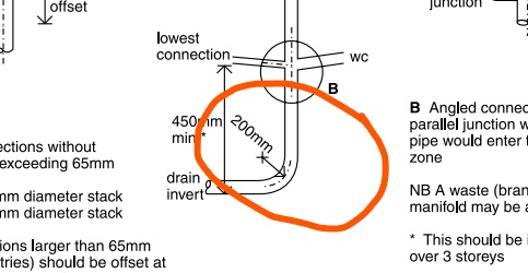

Good evening, need to replace my old cast iron soil stack including the bend at the bottom and a short length of clay pipe. I ideally need a black rest bend as the top of the horizontal pipe under the driveway is only 150mm below the finished surface of the drive (probs why the pipe is broken, new one will be encased in concorete), so I don't want the top of an ugly browny/orangy coloured rest bend visible. Anyone know if there is such a thing? Failing that I seem to remember reading somewhere that it is possible to use 2 45 degree bends as a rest bend, if so, is there a minimum length pipe I need between them, or can I just push a single socket bend into another one?
A related question, as the stack is on the front of the house, I am considering stopping it just above the WC level and putting AAV on the top as I believe this will look better than a stack all the way to gutter level, any reasons why I should not?
