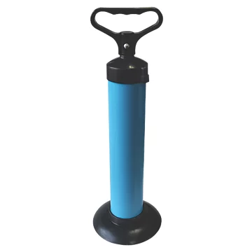

A pump/power plunger or a snake are best to try first.
As above, I would first have a go with a power plunger, some water in the sink should help dilute the bleach, but safety glasses would be a must.
Also, temporarily block up the basin overflow, and the shower drain, so the plunging goes to the right place!
