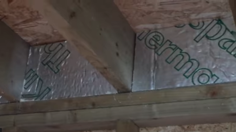

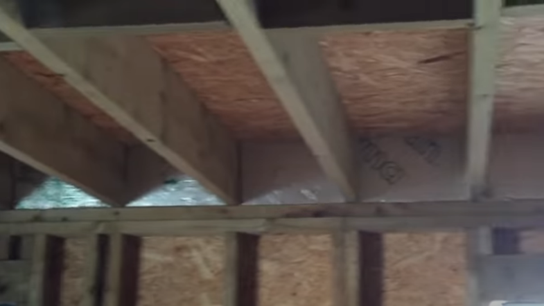

I found this video of a timber frame built although this is a garden room, the same principles apply. 11.45 is when he talks about different types of vapor barrier, 12.50 what he using and 15.00mins is of where the detail I'm wanting to know about. He says not to worry to much but I'm not too sure.

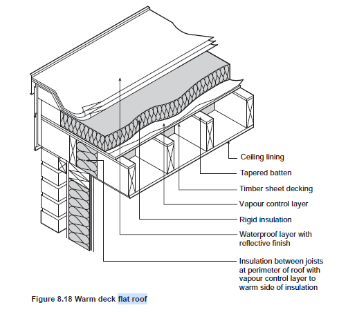

From Timber frame Construction by TRADA.
But I would lap the frame vapour barrier horizontally over those top two timbers you can see in the fame there

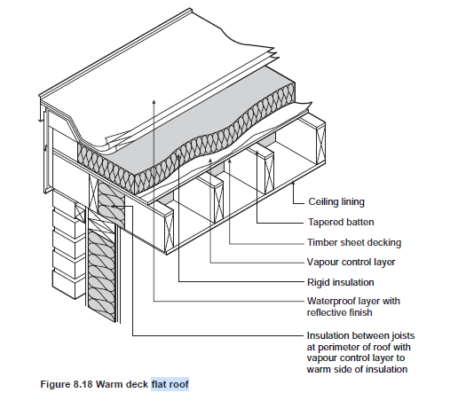

That picture wouldnt be all that great, although the wording of it is what i needed. Thank you woody! Heres hoping other members on here will come long with detailed pics of this detail of them doing it before.
Not my picture! Looking at this, its going to be a tedious work installing the vapor barrier up between these joists if theres no other way around it!
Would any member have any pictures of previous work of this detail.

i am answering my own questions here but something that i just found that i thought id post here for anyone needing this information in the future.
See video for the detail im looking.
