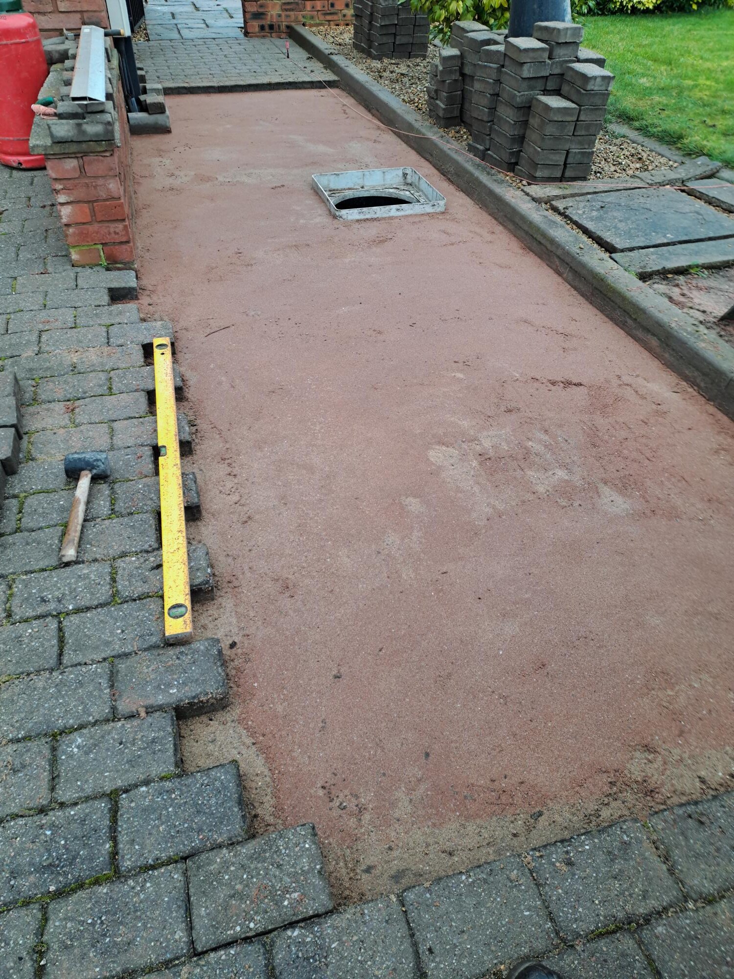

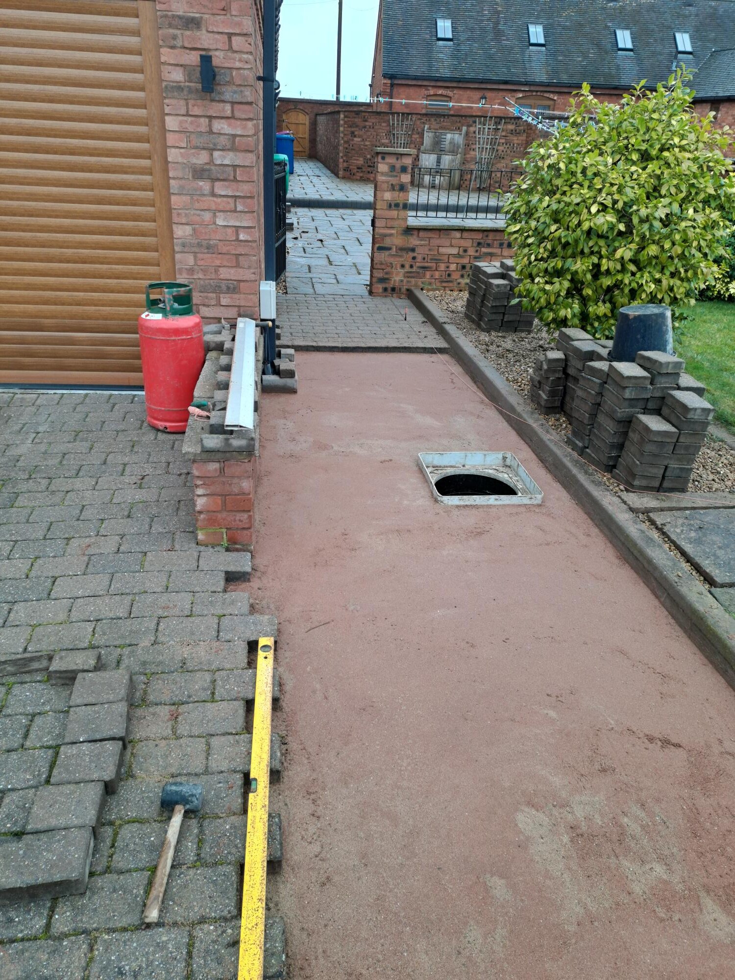

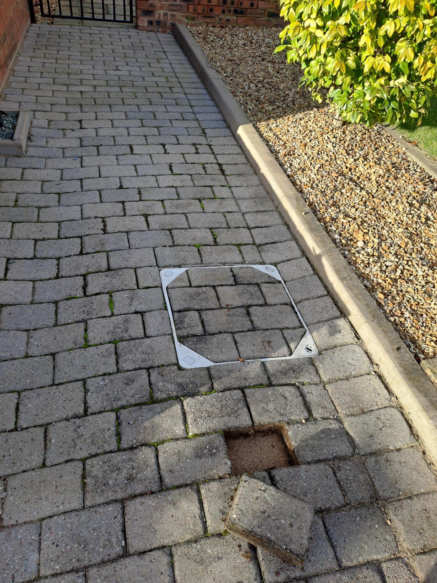

We repaired our sunken parts with grit sand. Kiln dried sand is for brushing easily into the gaps between the blocks, so you will need a little bit.
Ours was sunken because a HIAB extended a leg onto it, and lifted off a heavy load.
