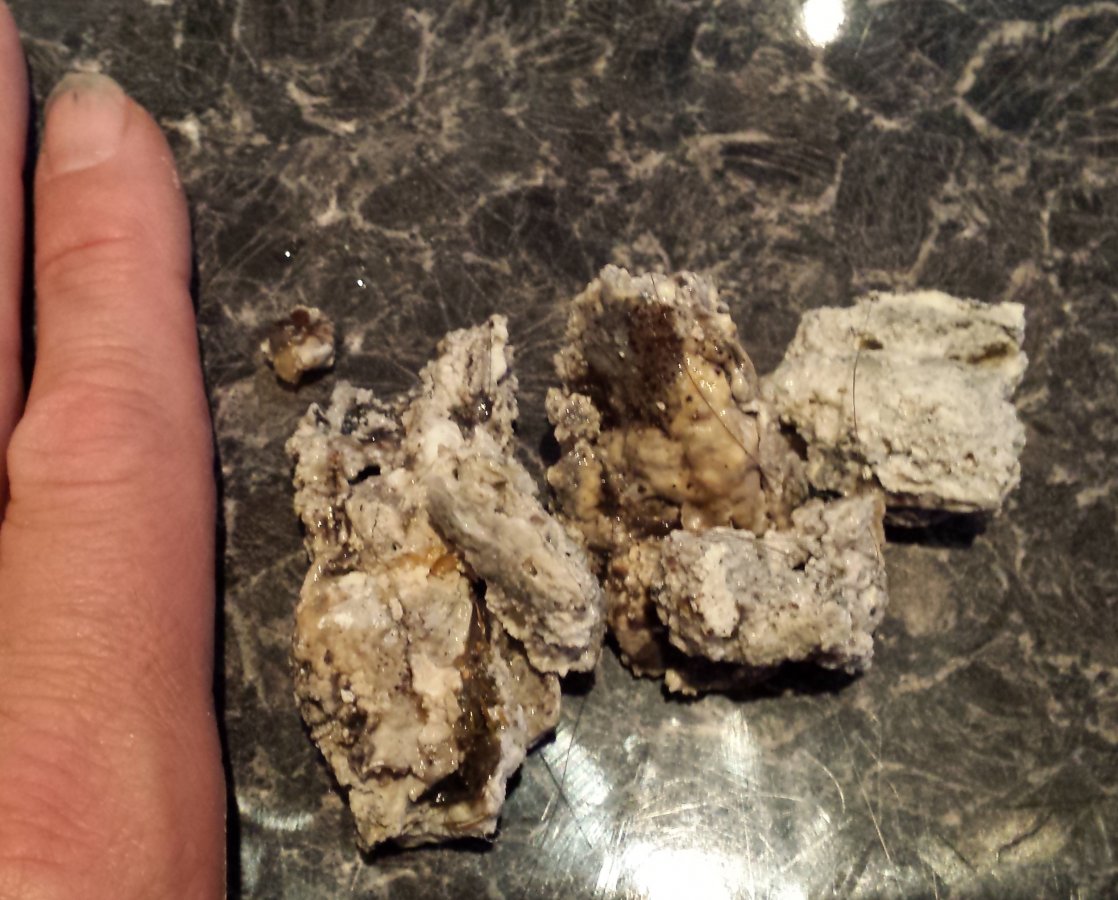

Before I tried the worm I tried the blowing method a few times. This is the crud I managed to blow through
White granular hard stuff, I'm assuming washing powder (even though we've used liquid detergent for years)
I've put the worm through a few times, back and forth quite vigorously. I've tried filling the sink up and then releasing it but it still backs up the downpipe from the washing machine a bit. To be honest there's about 4 or 5 metres of 40mm pipe that is near horizontal from the washing machine to the outlet outside.
Usual crap you get in a waste pipe it's just a matter of staying with it till you clear it unless you replace the pipework.
Looks like fat to me. You don't have to tip large quantities down the sink, even small amounts from rinsing off plates can build up, soon as it starts to cool it will solidify again. All the worm has done is drilled a hole through the middle of the blockage, to be honest, I think your best bet right now would be to renew the pipework. You'll never get it completely clean again now.
