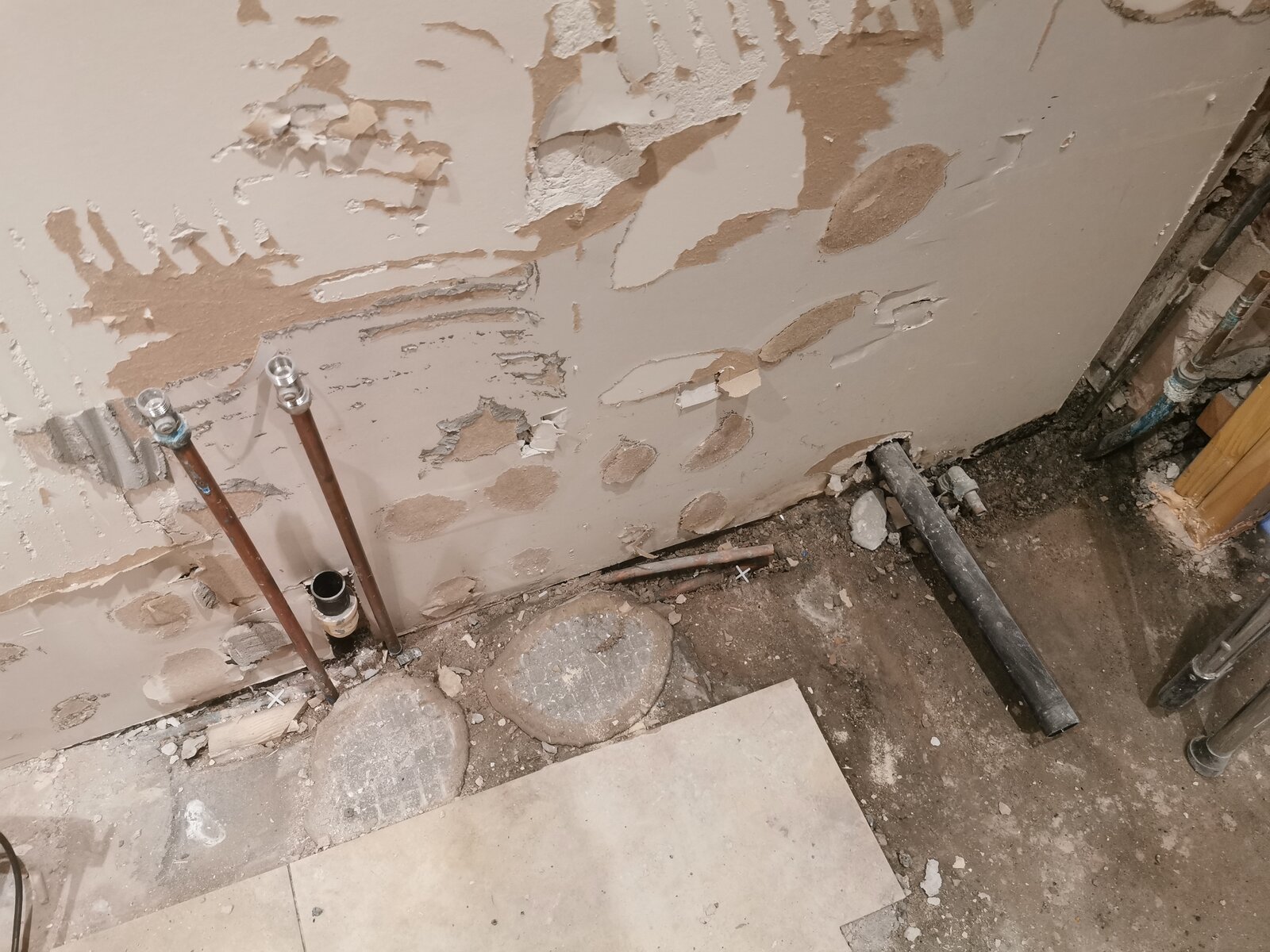

Evening all,
We're converting our old bathroom into a playroom for our daughter.
Removing the suite has left me with 2 40mm wastes and a 110mm waste to fill in permenantly.
What's the best way of doing this? I think the 40mm's may join along the run so ill chase them back to there but my plan was to use some expanding foam to give me a backing, push some wire wool into the foam then cement over the foam and wire wool.

You really want to get them as far back to the stack as possible, if not all the way back to the stack and then use plugs into the boss'/branch.
Unfortunately there under concrete so I can only access either end,
Should of mentioned its a ground floor bathroom.
So that's what I've got, that's a 110mm cap in the original clay soil pipe, the issue with this is it's raised above floor level so will need cutting back and I don't fancy a plastic cap stopping rats if any find there way in through the ic.
The 2 smaller pipes I'm fairly sure from memory join but I'll find out tomorrow as that bit of wall and the window above it are coming out.

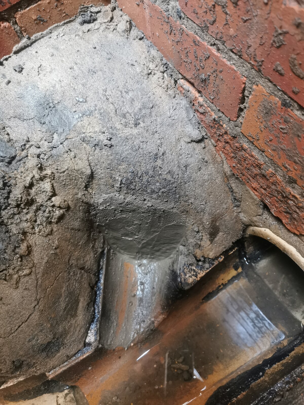

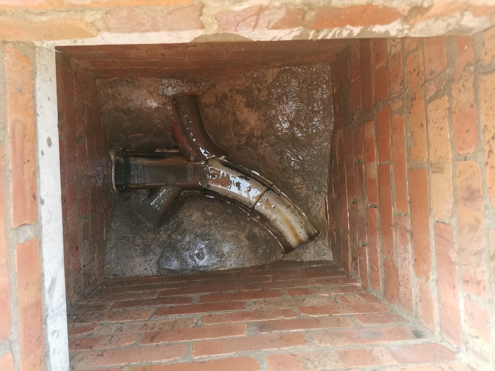

So the 2 40mm's both went into the same grated gulley, I can't access the gulley so I've just removed the pipes from it and it can be left to it's own devices.
The 110mm I've blocked with a layer of concrete, then some wire wool, then some more concrete to finish.
