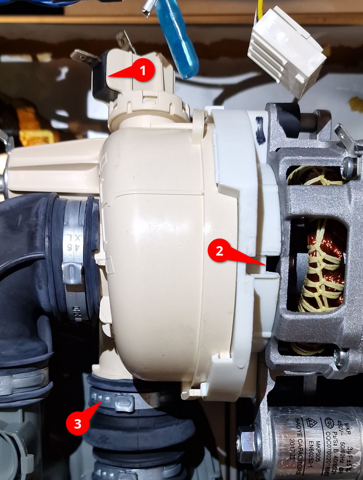

Steady drip [about 1/second] from bottom of pump/heater assembly. This eventually trips the flood sensor about an hour in to the programme. I am working around it for now with a towel but want a better fix, because fishing a damp towel out of a live appliance is a little more excitement than I'm comfortable with.
Can't work out how to buy gasket on its own. Motor with gasket is >£100 [eg https://www.buyspares.co.uk/dishwas...rrysessentials&path=543148&model_ref=11801993 ].
What would be a good way to bodge this? Ideally stopping the leak from outside the assembly, rather than having to dismantle it.

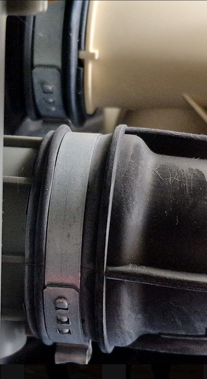

I was hoping you wouldn't say that! The hose clamps look like they're crimped on and not reusable [will post pictures later] so I think they will need replacing as well.
Hylomar looks like RTV silicone? So presumably I could just get some silicone from Screwstation or whatever? [I'm impatient here, want this sorted].
eg
These are the clips:
Very difficult to manoeuvre in there. The dishwasher is built around the black plastic base, seems like the pump was one of the first things to be fitted and then everything else was built on top. Pretty much guaranteed to be uneconomical to repair. :mad:

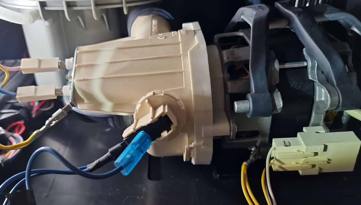

I'm such a mindless brute, once it was on its side, there's the access panel, so the jisgaw rests easy.
Unfortunately there's water around the microswitch 1, can't explain that.
If I shine a torch into 2 it looks wet, so I suspect it's actually leaking through the bearings.
The hose clips I got are too wide for 3.
I've left the access panel off, put the flood switch to one side and sat it over an oven tray. I suspect this is how it will stay, until the next thing fails on it and we just get a new one.

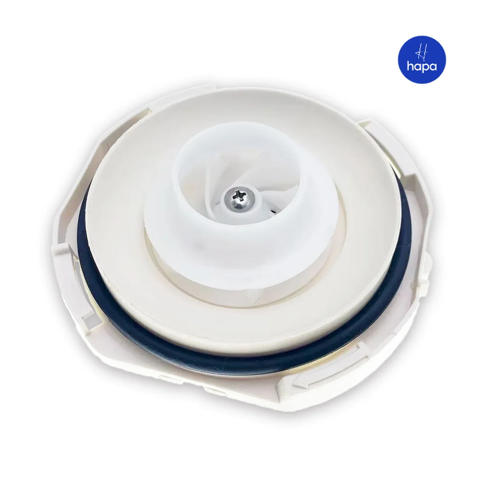

I am now convinced that it's the seal where the motor shaft goes in to the pump, because the dripping does not happen when the machine is not running.
Here's the proper part, £20.
That seems to be a fair assumption, and £20 is not a great amount to risk.
