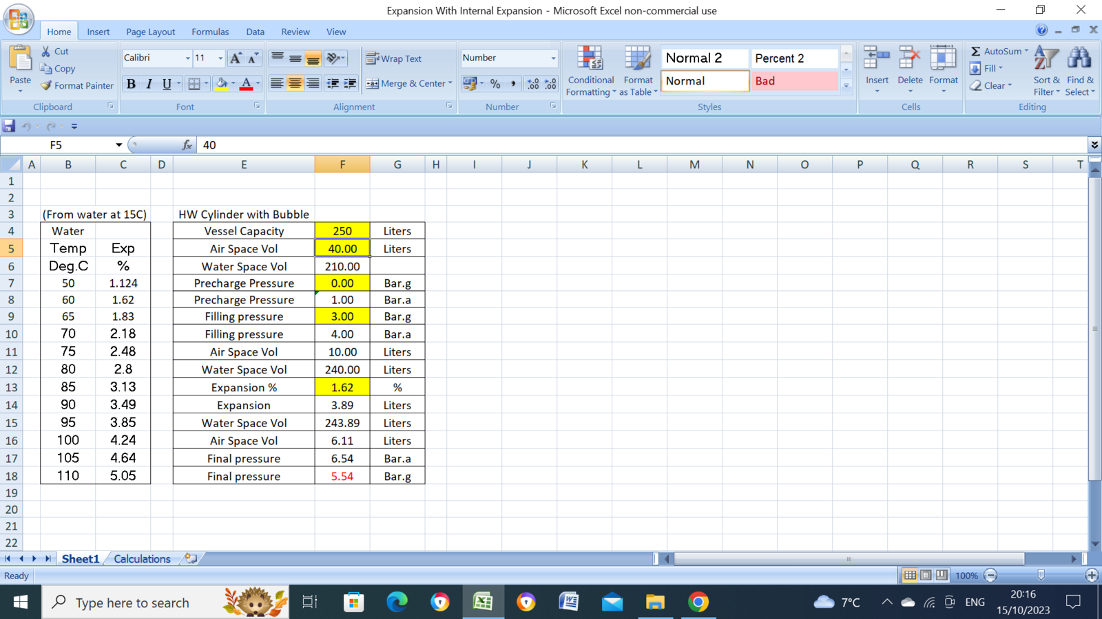

Any HW cylinder with a air bubble will not have its full capacity of HW available.
Assuming the hot cylinder pressure is not allowed to reach more that say 5 bar then the HW dip tube in a 170L cylinder must extend "30L" downwards into the cylinder, there will be 165L of hot water at 5bar but only 140L of this is available as HW as the cold mains will start entering the dip tube end once the 140L is used up.
That depends on the manufacturer, surely?
For example: My Oso cylinder: the makers state that one can increase the tank capacity by circa 20% if an external pressure vessel is fitted. My nominal 210 litre tank without the dip pipe holds 250 litres according to the installation manual.
Heatrae-Sadia who make Megaflow may calculate their tank capacity differently of course?

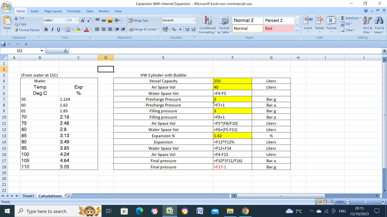

Of course they can calculate it differently, if I take it that your Oso cylinder has a air bubble of "40L" then a PRV setting of 3bar and heated to 60c will result in a final pressure of 5.54bar, the pressure will fall to 3.0 bar when 3.9L of HW is released.
The Megaflo has a baffle as well as the diptube so how are these removed to increase its usable capacity with a external EV I wonder.
For anyone interested, you can change your own values here once you build your own spreadsheet. Can't post my Spreadsheet file.

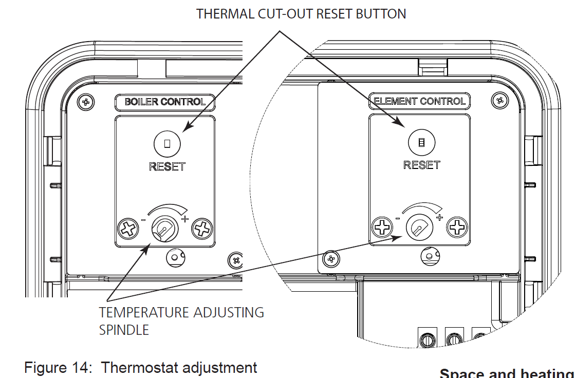

I don’t see a thermostat on my cylinder.. I assume it’s only inside and cannot be set to a temperature (temp only set on the boiler) and that’s why I don’t see it ?
It may be inside the cover in a plastic box about 1/3rd the way up from the bottom, it has to have a thermostat otherwise the boiler would only switch off when programmed off or turned off manually.
The thermostat(s) is inside this box, factory setting is 60C and the setting appears to be pointing to ~ 1:30 o'clock, I wouldn't advise touching it, go away and measure a HW tap outlet once the cylinder has fully reheated.
