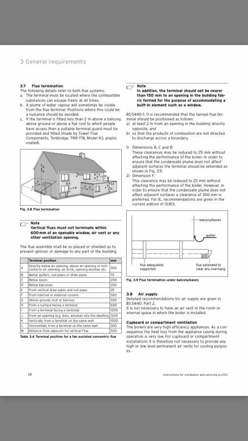

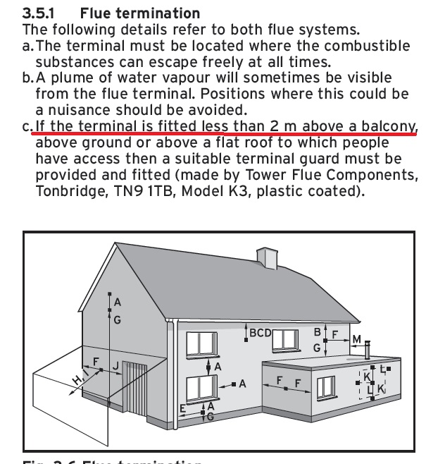

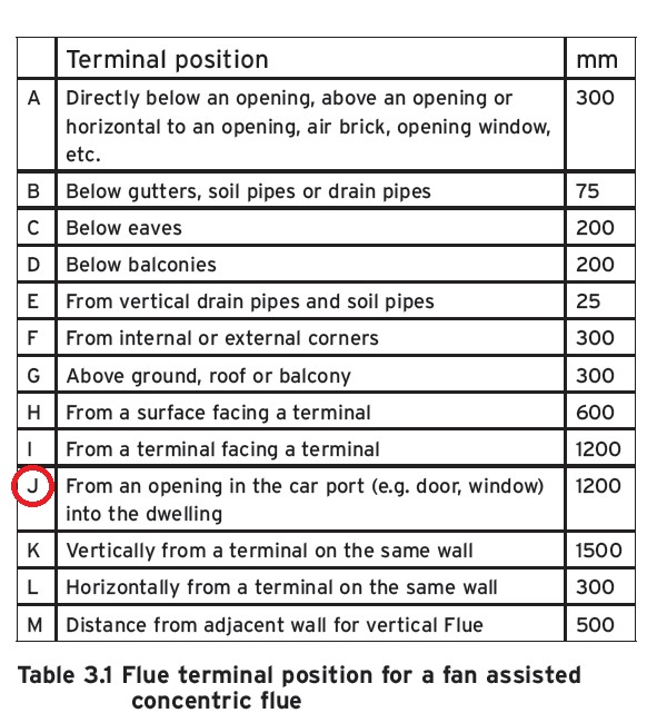

Some manufacturers include car ports in their instructions about the location of a flue terminal. To me that balcony is similar to a small car port when considering flue gas dispersal.

Andy, as has been said... The Manufacturer and Gas Safe are the regulations that rule over all else!
The MIs will tell you what is permitted for an individual install but as there are so many flues terminating under a single, shared canopy then it may be something that Gas Safe AND the manufacturer needs to discuss and agree upon.
Here are the MIs regarding flue terminating and siting for the Ecotech 624 for you to peruse...
The critical issue is the fact that the glass canopy encloses the air and appears to be closed at at least one end.
You will see that the Vaillant guide assumes open ends, which will allow combustion products to disperse.

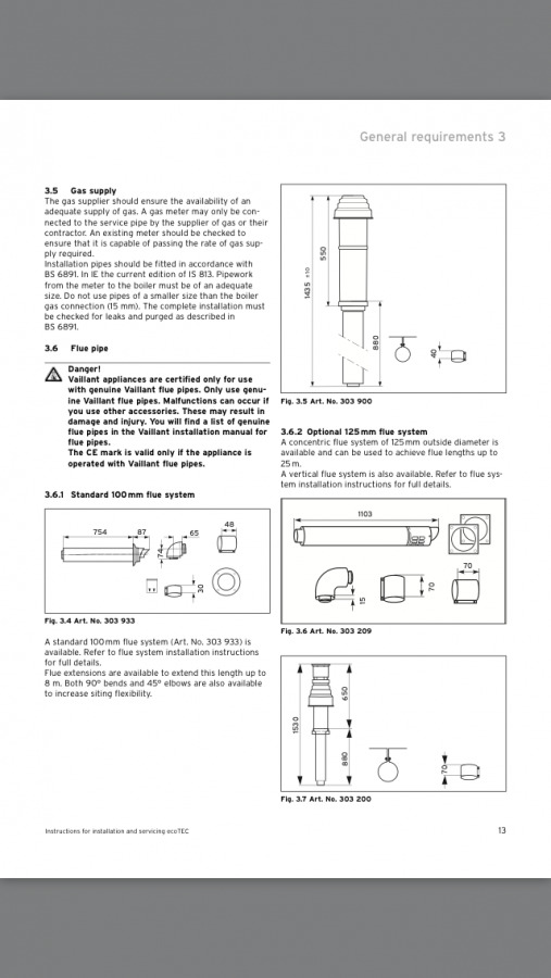

If using vaillant boiler, can't the flume management kit be use? Sited the flue as normal and use the flume kit to take the FOC toward to the front of canopy?
Just an idea...

Vaillant refer to it as a "variable terminal kit" as opposed to a "plume management kit"...a big difference with regard to flaunting the regs...
