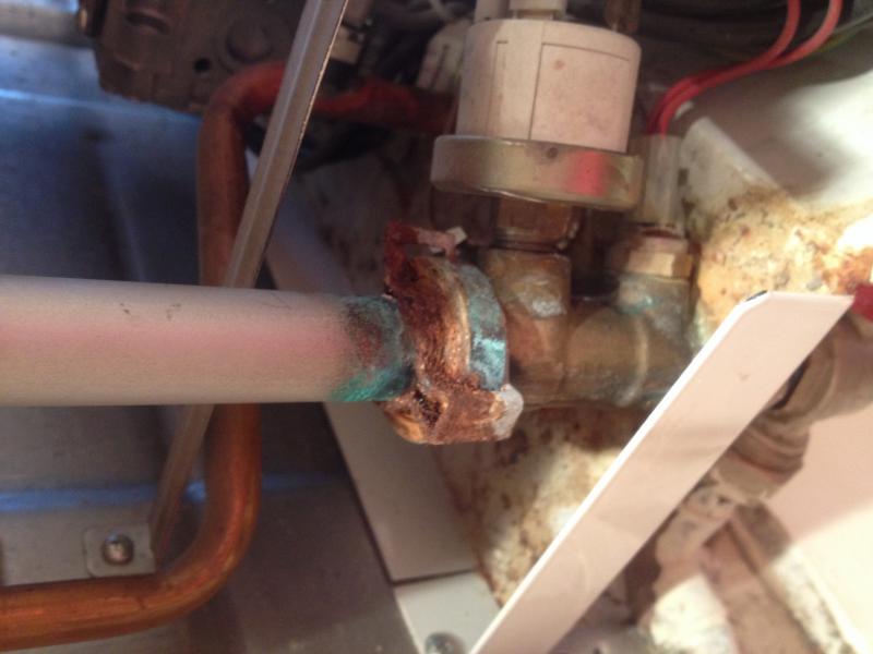

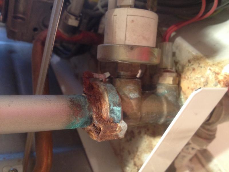

We have a ferroli Modena combi boiler and have a leak .
When the heating is on it does not leak but when you turn the heating dial down to hot water only or overnight etc it is always leaking in the morning .
Took the front off to see where the leak was and it is from the pipe above the prv the one that comes out I think for hot water /heating
My question is : is it fixable or will it be condemned by a plumber
Thanks in advance for any help :)

There is a chemical that can be injected into the system that may do the job. And yes the actual leak is probably just a washer or O-ring (not checked the manual to see the construction of the joint).
The boiler is a joke though and likely to have other issues when worked on.

The leak is evaporating off when the system is on - hence the crusty build up.
If you use the chemicals the system needs to be running for the chemical to take effect.
How effective it is I wouldn't like to say.
This an unfortunate but common case of a long term leak which has not been addressed during an annual service.
The result will be a severely corroded component. It is totally repairable but finding an engineer willing to take the trouble is going to be difficult.
In my area I would repair it because I am too helpful but as the boiler is an unreliable design that's not good economics. Might cost about £150 to repair at my charges! Better put towards a new boiler though!
I don't subscribe to using leak sealer! Only to repairing the leak!

The problem is the pipe is part of the heat exchanger...so any damage to it whilst trying to free it from the brass manifold will write off the boiler.
If the boiler's only to last a few months give leak sealer F4 a go first.
Leaving it leaking causes no problems for a few months more!
Looks like its been leaking for years already!
Its quite possible that it could be cut and a new bit spliced in to go into the replaced fitting.
