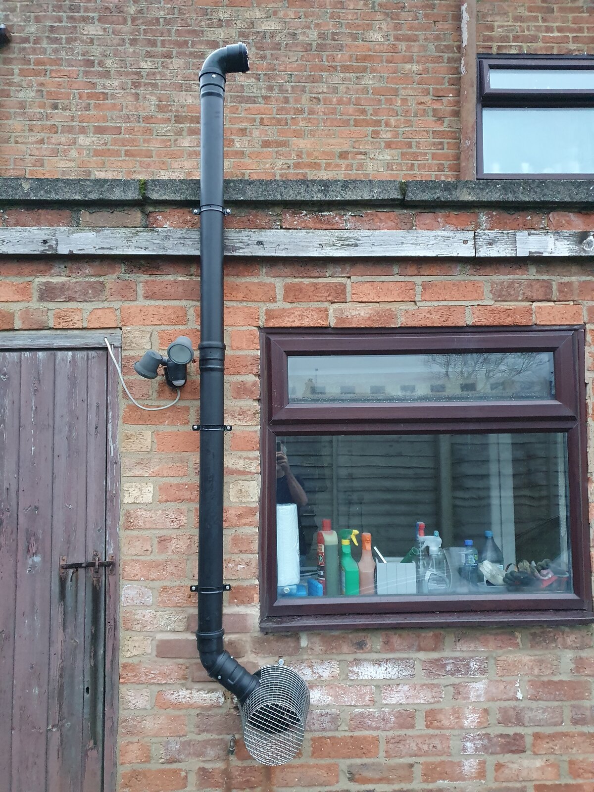

Hi guys.
I had a new boiler installed approximately 18 months ago, but it seems to regularly lockout with code 9F 855. The installers suggested a frozen condensate pipe, however, it happens even on frost free days. Our oil tank was replaced at the same time, so unlikely to be from contamination (imho). The only common factor I can determine is that the weather is extremely windy each time the lockout happens. Whilst the wind persists, it's difficult to reset the fault, often getting to 856, where a power cycle is required. Once the wind dies down, it resets immediately with no problem. The flue has a long extension kit, mainly because it exits a wall close to an opening window. I've tried rotating this in all directions, but the problem persists.
I'm really just looking for opinions that I can take back to the installer. Is it possible that the wind is interfering with the flue operation, or is this a red herring? The boiler is a Worcester Bosch greenstar heatslave ii.

Could well be flue some clear pictures would be useful.

The condensate pipe definitely not frozen. I've attached a picture of the flue. It's just shy of 2 metres long.
With the exception of the 45° bend that's a standard length plume kit.
We fit plume kits on virtually every Grant we fit sometimes twice that length with zero problems.
Get installer back to check flue has been correctly assembled.
Would also check MI for distance between flue and opening windows. On Grant's its 1 Mt that looks close!

I wonder if that 90 degree at the top, might be facing the prevailing wind direction?
That was my initial thought, however, one of the first tests was to rotate it to various positions over a number of days, with the same result unfortunately.
