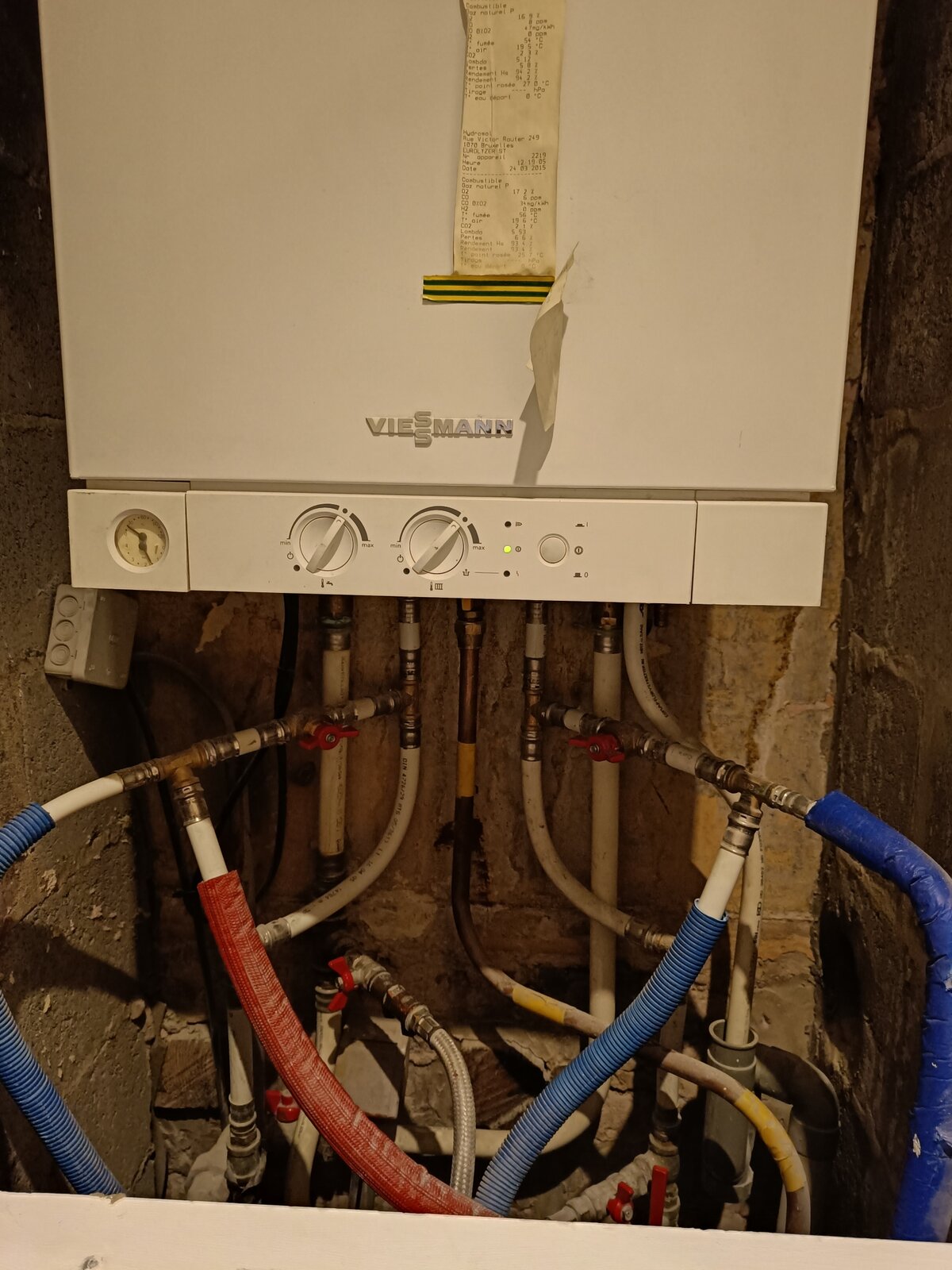

I have a Viessman Vitopend 100 combi boiler that loses .1 to .3 bar of pressure each time I turn off the heating (depending on how long it's been running).
I ran a short test the other day where I turned the heating on for only 5-10 seconds. I could hear the ignition and the water pump kick in. After I switched it off, the water pump continued running for another 5 minutes or so. But, the moment it stopped, the pressure immediately dropped by .1 bar.
Video (with sound): https://streamable.com/m23rk2
The heating works fine, but I have to refill the system every day to get the pressure back up to 1.5 bar.
We moved into the apartment only in September. We had our annual boiler maintenance in November and hadn't used the heating before that. Is it possible the technician forgot to tighten a valve somewhere?
its normal for the pressure to fall by 0.1 to 0.3bar, 1m to 3m, when the pump stops, it should also rise by that amount when the pump starts but certainly doesn't account for the daily top ups, next time its topped up to 1.5bar, watch the pressure while the whole (rads) system heats up and see if the pressure approaches 3.0bar, if it does then the PRV, above, should start lifting and dumping water, sign of expansion valve requiring attention, possibly air end needs re charging or a failed diaphragm.
The pressure you see at the start of the video (around 1.6 bar) was like that before switching the heating on. Again, for the sake of the test, I ran it for only 5 seconds or so, then immediately switched it off. I did not notice it rise, but the drop was quite obvious.
I have already checked this. It never goes above 2.5 bar. :/

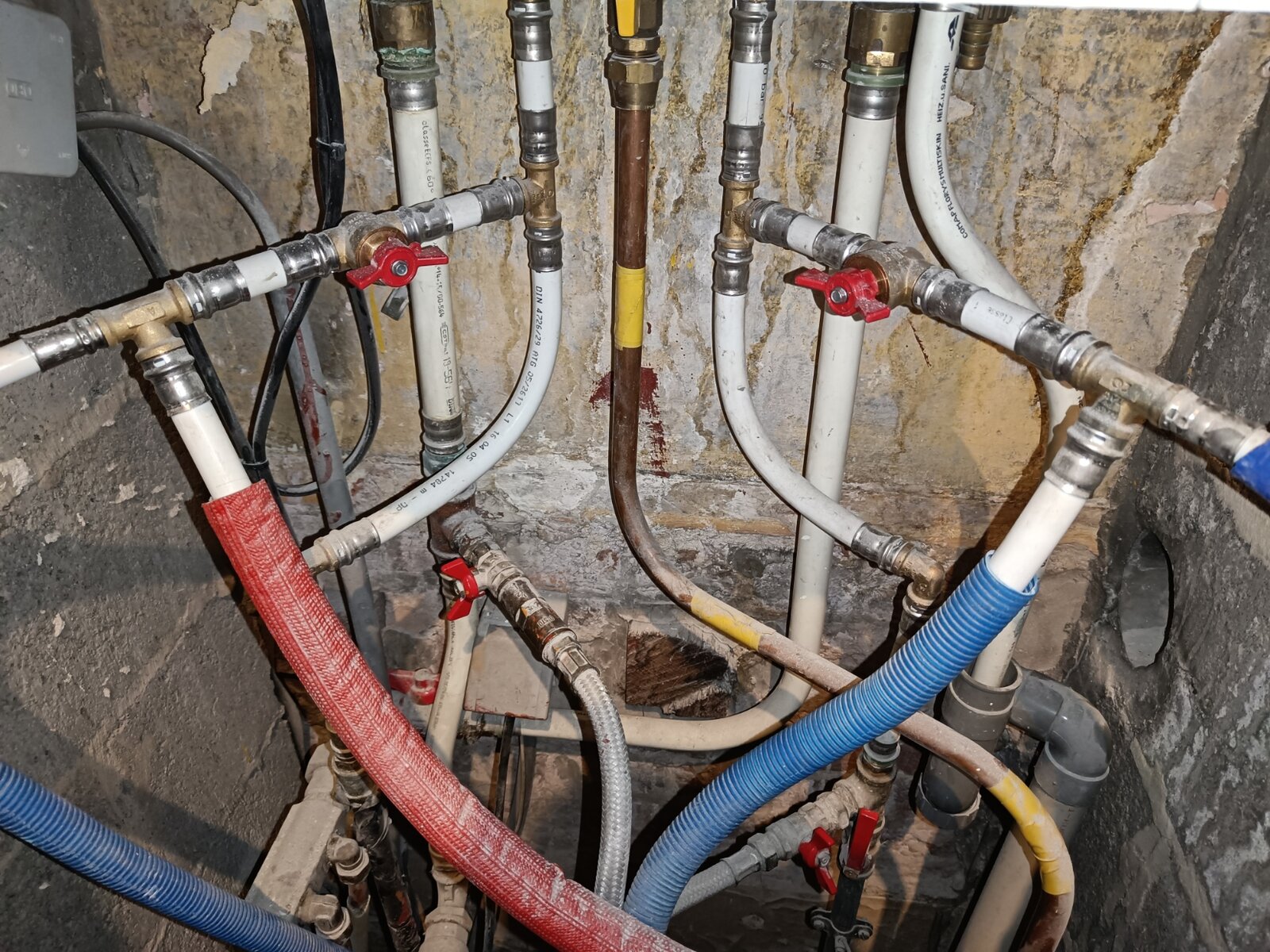

It's the white flexible hose on the right hand side that goes into the open
ended grey drain pipe .
Unfortunately that stupid design also takes the condensate from the boiler down that pipe ,so you can't tell if water from the PRV is coming down it as well.

Oh my, that's a proverbial minefield. I take it all that pipework runs into conduits that's are in concrete?
That being said, when the boiler clicks off it sounds like there is a slight release of pressure somewhere. When it does that can you see water being released down the grey pipe that the white pipe runs into?
