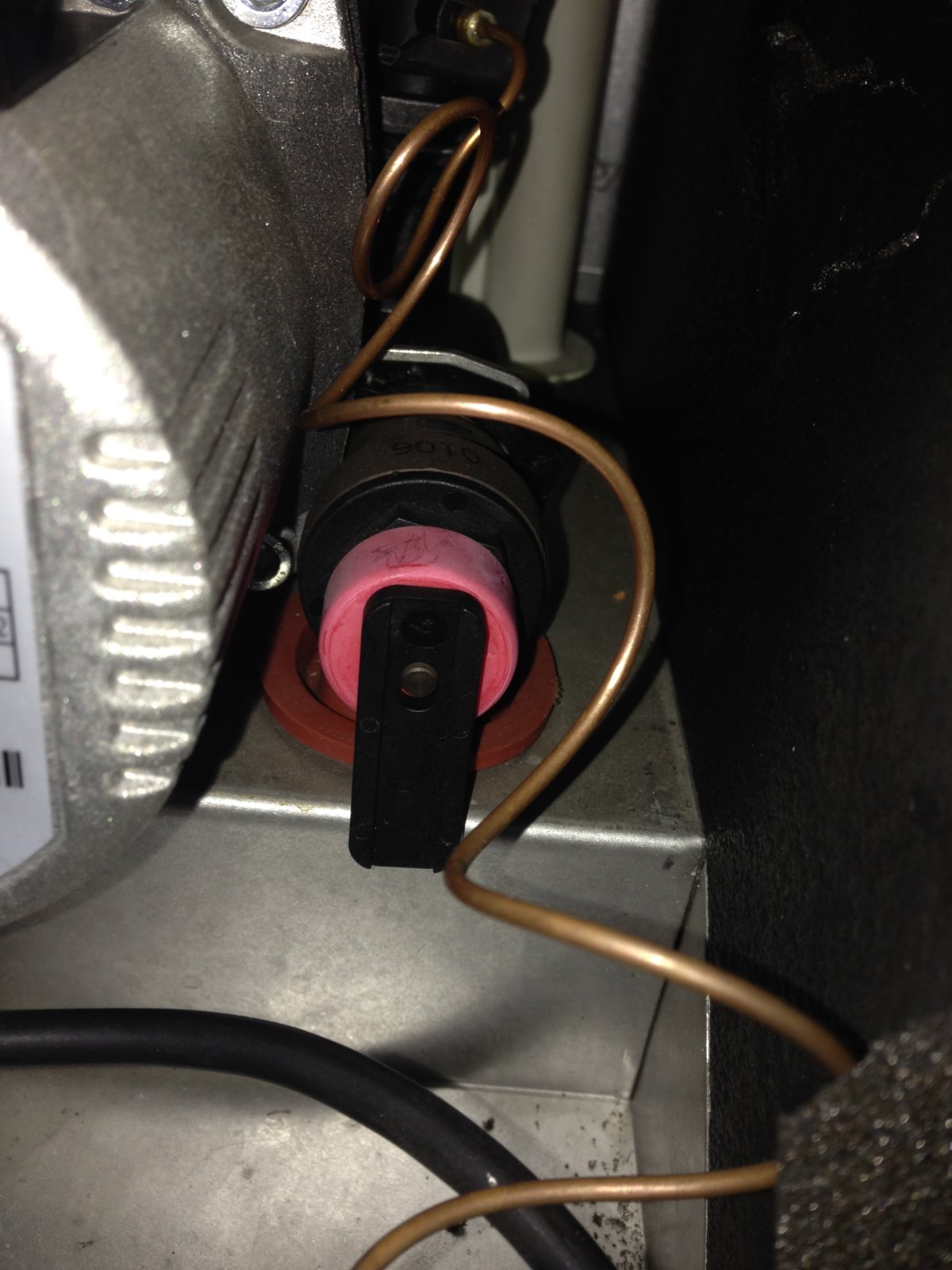

I have a Valiant Ecotec boiler. It keeps losing pressure which makes the F75 error occur.
I believe its the pressure release valve - red coloured. How can I fix the valve?

You can start by creating your own thread rather than hijacking the Op's.
Then you can go to the gas safe register website and look for a professional in your area as you shouldn't be poking around in there.
