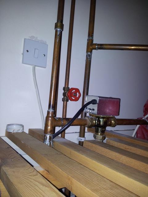

Hi Guys, hoping someone will guide me in the right direction. I have recently bought a new place and heating seem to be working ok till a couple of days ago. I have been doing a lot of reading to familiarize myself with heating system.
Problem:
CH comes on when HW is water and once water is heated, boiler goes off. I have checked thermostat and its set to max.
Boiler: Greenstar Ri condensing
I have been reading up on such issues and have finally locally the valve in airing cupboard, it says Honeywell F4 0540 D. This valve has a lever kind of thing which says Auto on left hand [my left] and MAN on right. Nothing in middle. I have tried moving it to MAN and AUTO but it makes no difference. Valve stays in same position AUTO when I turn HW on or OFF.
I would really appreciate if you can help me out here. Boiler is still under warranty but when I called the guys they said that its not the boiler but something else in the system.
thanks
three port vavle has gone most likly
check it by feeling the return pipe as it get`s warm if it hot then it tell`s the boiler to shut down
also check the rads when it does this at the bottom

Pics below and all pipes are cold

It sounds as if the valve is sticking.
Is there a small bump on the top of the cover - it looks like it from the pic?
If so you can remover the actuator - that's the metal box.
Turn the power off to the system.
Lock the lever in the notch at the MAN end
Remove the cover (screw at the end)
Remove the actuator (two screws in opposite corners). No water will come out.
You will then see the valve spindle.
This should be able to turn easily by hand - but less than a quarter circle.
If it is hard to turn, apply a small amount of silicon lubricant to the spindle and use a pair of pliers to free the shaft.
Replace the actuator and cover.
Release the lever, which should move over to the Auto end with a whirring sound.
Push the lever to the Man end - you should feel resistance - and let go. It should return to the Auto end.
If this is OK, turn the power ON and check the boiler works for HW, HW and CH, CH.
You will not see the lever move from the Auto end, but when you have CH on (with or without HW) the lever will feel floppy when you move it to the MAN end.
It has been working alright now since the "fiddle". HW and CH both come on separately and together.
