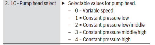

Did you say the pump is inside the boiler, and you have set it to maximum?
All boilers start off at a higher burn rate. The usual figure quoted is 70% of full output. So your boiler might actually start about 17KW. And then what we don't know, is how long it takes to drop down to 7KW. Some do that almost instantly. WB should be able to tell you.
EDIT: are these the options you have for pump speed? If so, which have you chosen?
