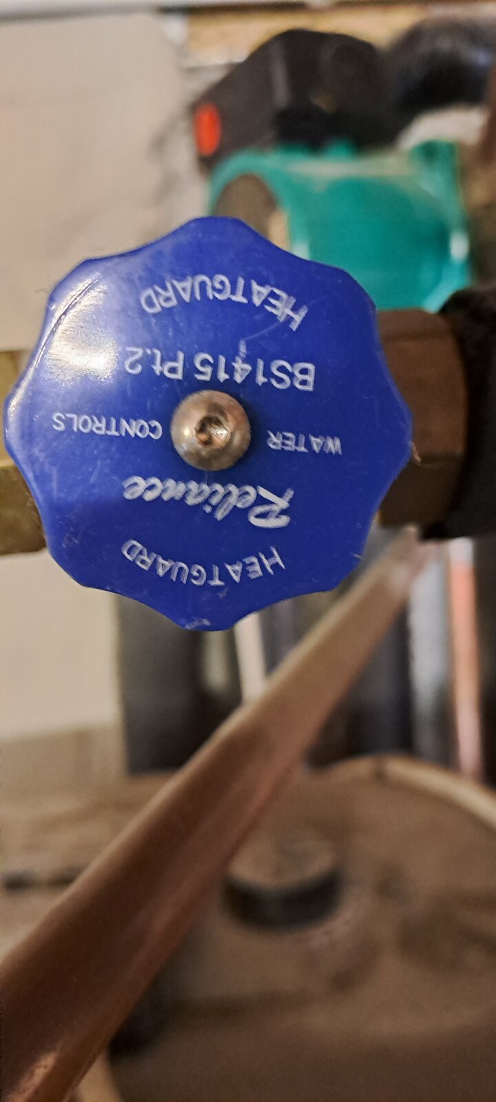

Can you see what is written on the blue TMV? on top of the HW cylinder?
Cylinder is a Smartline E300 thou seems bigger.

that cylinder is an ACV smart E plus 300 . it is a tank in tank design cylinder.
