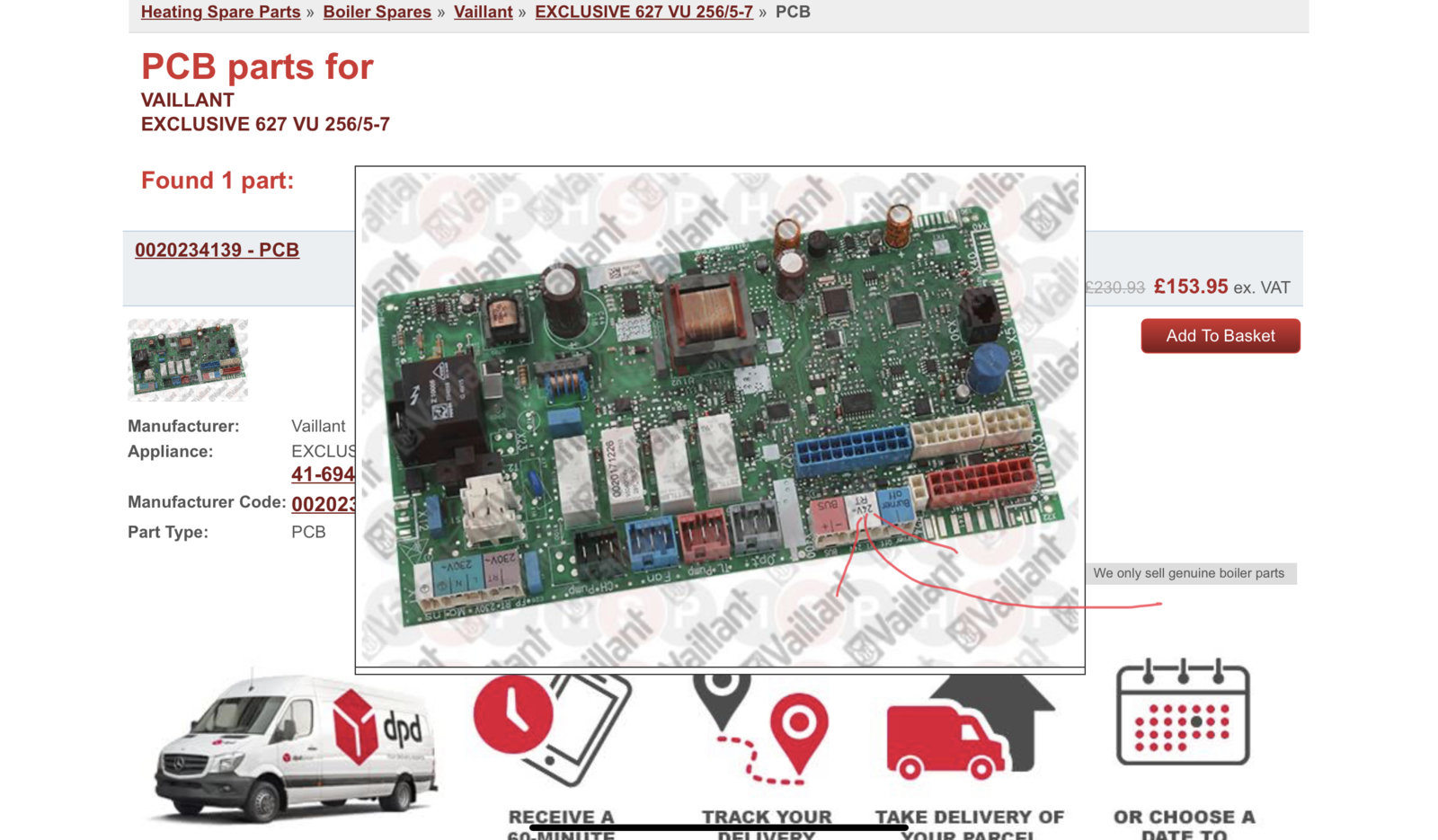

When I had a new Vaillant heat only boiler (EcoTEC plus 418) fitted a couple of years ago, I had the same symptoms as you on the very first night - constantly circulating the water even though both thermostats were turned right down. I even turned the heating and hot water controls off but it still ran. While I was waiting for the installer to return the following day, I called Vaillant. Before I had even finished describing my fault, they stopped me and asked if I had Vaillant controls. When I said I didn’t he said "They’ve not removed the 24v link inside the boiler". I told him it was a Vaillant approved installer and he just said they all forget to do it. He told me Vaillant controls are 24 volts and if you use any other makes you just have to remove a small link inside the boiler. I removed mine myself and it was all good from then on. Perhaps that’s your problem?

Interesting. Do you happen to have a pic of where it is? We don't have vailant controls

This was where it was on mine - not sure what model you have but it will be in the online installation manual for your model. I just removed the 24v link.

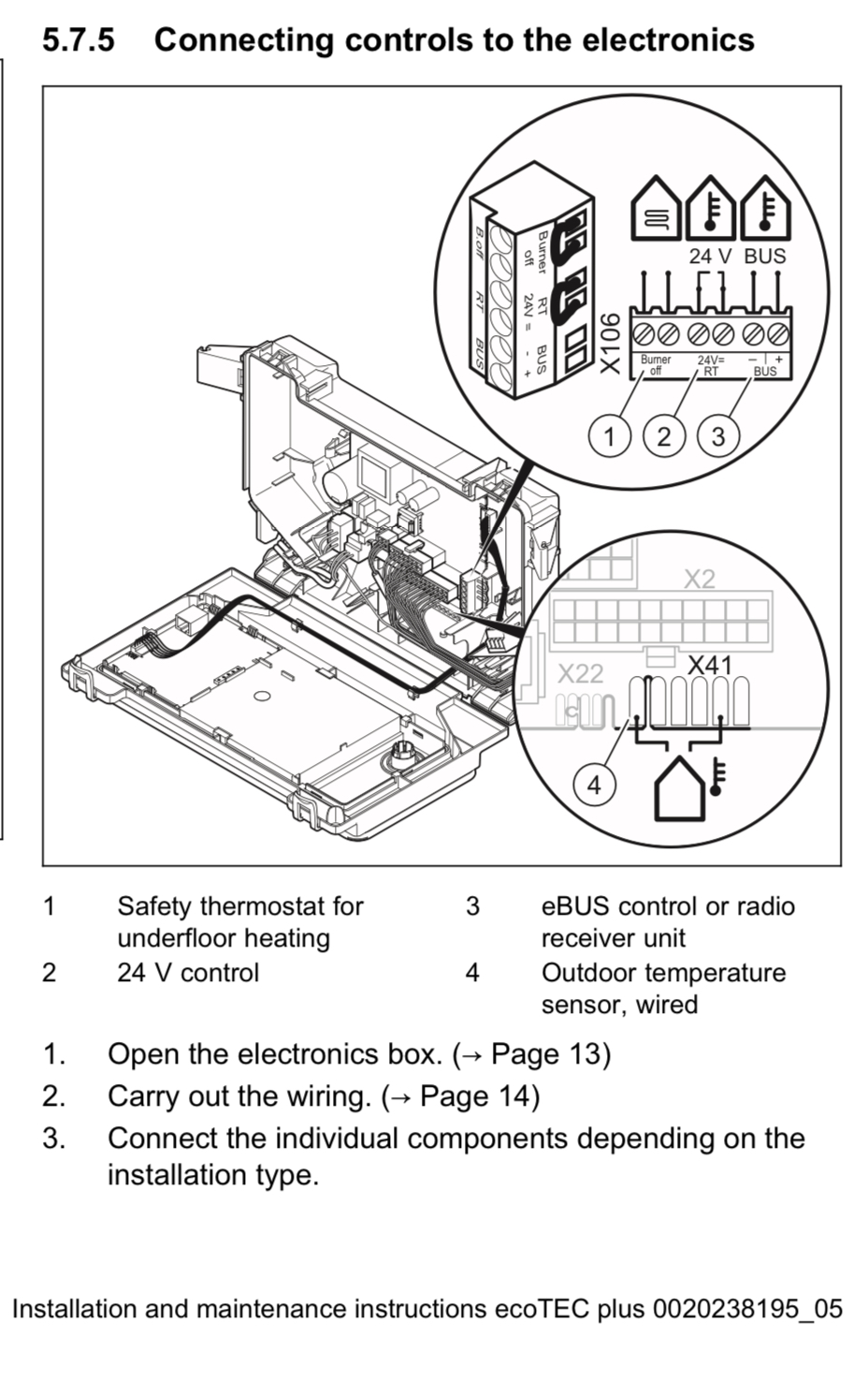

Mine is an Exclusive 627.

Sadly doesn't look like there's anything 24v mentioned in the manual ☹️
Your boiler has a 24v plug on the pcb as already said, get the installer back to remove it.
As far as I know, Vaillant controls are 24v. If using other makes, the link has to be removed. That’s the limit of my knowledge I’m afraid. If your controller is 240v, it shouldn’t be there, that’s what I was told by the Vaillant tech guy. Might be worth seeing if it has been removed first.

Upload a photo of your board.
Disconnecting it won't do anything apart from make it work. It's not meant to be there if using 240v controls.

Will do when I can get up to it.
I'm not sure why it would be working at all if it were in place tho?
