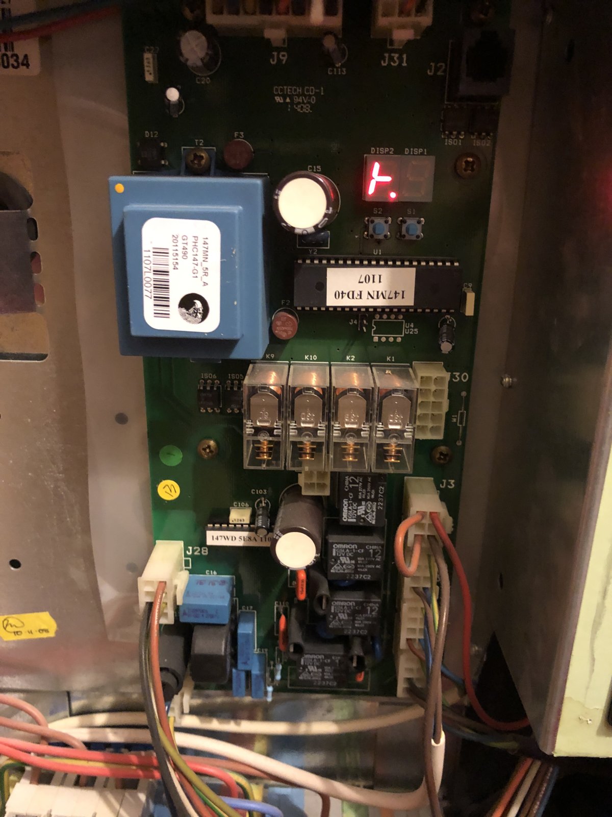

Hey Guys
Dare I say I have a Boilermate OV A-Class linked to a Potterton boiler in my home which I bought new approx 11 years ago. Although I have only had a couple of problems with the A Class, the problems that have happened have been pretty major. One time no heating (issue with the main board), second time no hot water (heat exchanger issue - scaling, solved by a softner and new exchanger).
Now, in the morning only, showers go from hot to cold, but hot water is good in the taps. Current environment is:
1. Potterton Boiler has not been serviced since 2015 ive had to reset it a number of times due to no heating/hot water
2. The Expansion take on the top of the boiler mate has very little water in it
3. Please see the attached picture, not sure if this is showing an error code or not
4. I figured that my first step is to get the boiler serviced, but then I read that its actually the boilermate that controls the potterton.
5. Ive loosely wrapped the A Class with insulation has in the summer the heat from the cupboard dissipates and it gets very very hot.
My questions:
1. What troubleshooting steps should I take? I figure the little water in the expansion tank of the boilermate is an issue, what/how should I check?
2. Do I pay 80 uk pounds to an independent gas engineer to service my boiler? or shall I sign up to British gas home care as they can deal with any future issues?
I am a total newbie to all of this, so I would be grateful for your basic instructions and advice
The boiler needs to be serviced. Use an independent - British Gas will just try to sell you a new boiler.
As for the Boilemate - it belongs in a skip. Dispose of it at the first possible opportunity.
Thank you Flameport I couldnt agree more, but I am assuming thats not a small job and could cost a fortune right? Plus what would I replace it with?
